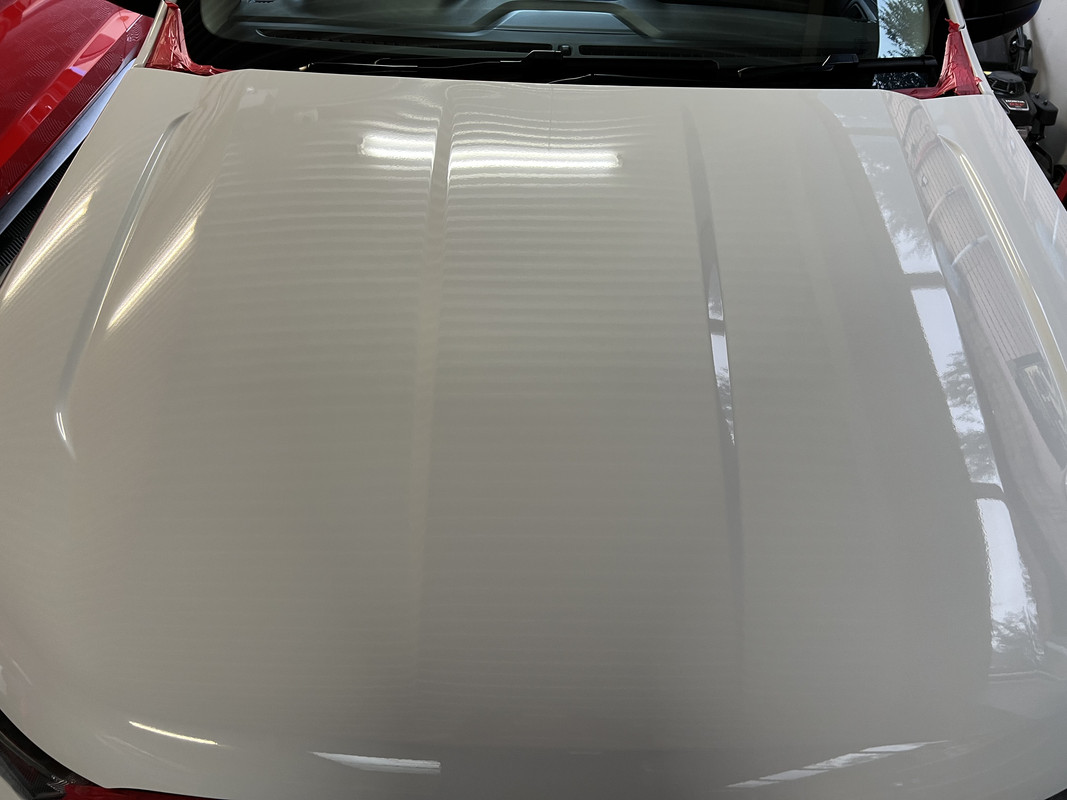

Up until this point things were going very smoothly. The paint on this car had some really weird oxidization on, something I have been aware of for a while now. Hence me saying a few times that the Ranger really needed to be polished.
My initial plan was to use Perfect Finish with the blue Shine Mate pad on a test spot and see what I would get. After wiping, it was obvious I was going to need more so I went to the yellow Shine Mate pad. This got it to where I wanted in the end, but I had to fight for it.
In hindsight and proof that I'm still learning, I probably should have gone to Sonax Cutmax, and then cleaned up with Perfect Finish as a second step.
It was head down until the final wipe down with Eraser. It's been a long time since I have seen the paint look so clear.
It was then onto applying some protection. I did actually contemplate using the Ranger as my first ceramic coated car. Something like Gyeon Q2 ONE EVO or Gtechniq CSL. In the end, I did not want to be left worrying about the prospect of water spotting on a car that is used in all weather conditions. Collinite 845 it was then.
After the wipe off, that's where I hit the pause button until tomorrow.
Flat white is such an unrewarding colour to work with, at least until you step back and look at the car as a whole. Without the metallic flake, you don't tend to have the same indication that you are achieving something.
