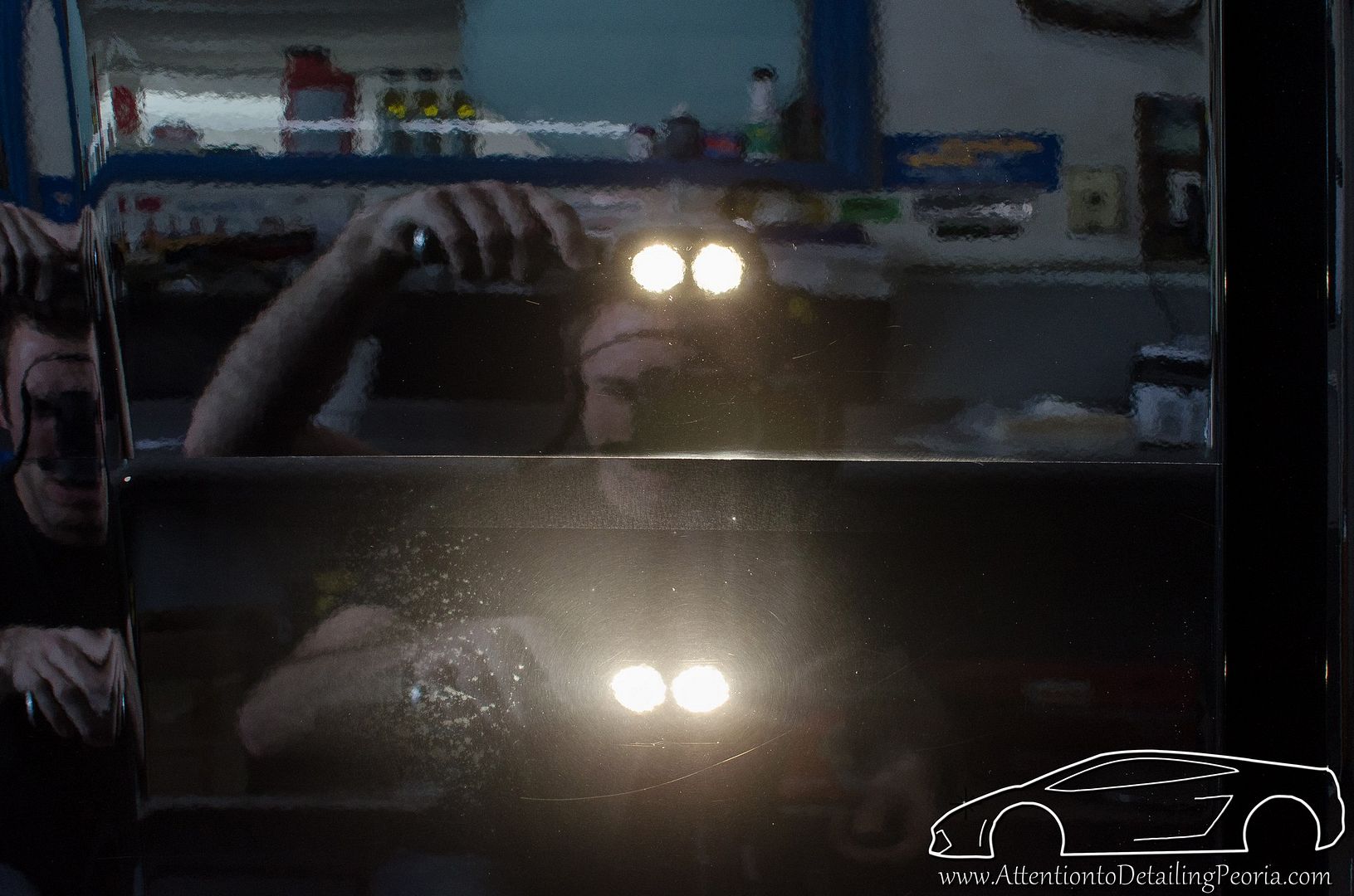

Thanks for posting your preferred combos AND the great photos
I dislike it when Forum Members claim great results, but never seem to include any evidence of their results
Well done
Thanks for posting up some combos Zach, do you have any techniques you recommend?
I used CarPro Gloss pad and HD Speed on this Audi. the 3rd pic you can see swirls where the flash is and the 4th pic here are less
