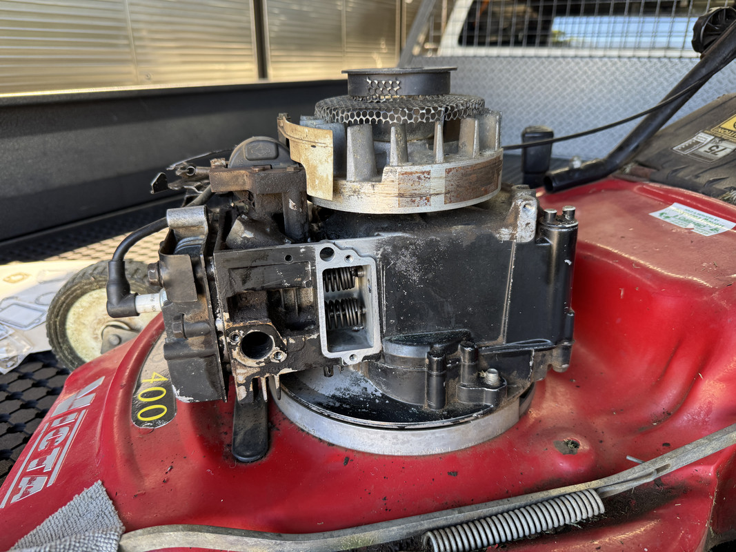

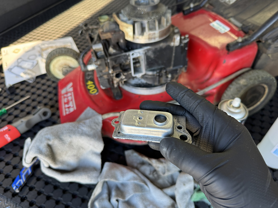

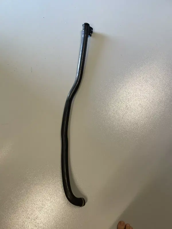

More work on the Victa Corvette 400. When I put new rings in the engine last year, I noticed the breather tube wasn't screwed into the block. For some reason, the threads were all worn off. Probably not a major problem, but I decided to order a new one.
Briggs and Stratton - 692145
These breather tubes come from an era when everything was made of actual metal and not plastic. I'm fairly sure they used that same part since day dot and only disappeared when Briggs stopped making the old side-valve engines. I'd say they made billions of those things over the years.
Old breather tube, the black splatter on the left is paint overspray from the factory...............
To replace the breather, which makes a connection between the valve cover to the carburetor, the recoil cover needs to be removed. The tube threads into the block and is connected to the carburetor with a rubber elbow.
This job ended being a "while you're in there" situation. I noticed there was some oil/dirt build on and around the muffler, valve cover and a blower shroud. So....................
With the muffler removed, I then cleaned around the valve cover before removing it and the blower shroud. Both were cleaned, and old gasket material removed from the valve cover. The valve cover also doubles as the crankcase breather.
While I had the "muffkin" off, I decided to give a bit of a facelift. First, a wire brush, then sandpaper to remove some burnt-in plastic deposits (don't ask), then wet/dry paper, then Autosol metal polish. (See, there is some detailing going on here despite the focus being on mowers, not cars)
I then reinstalled the valve cover with a new gasket I had left over from the set I used last year, reinstalled the blower shroud and muffler, then the recoil. So, one job turned into three.

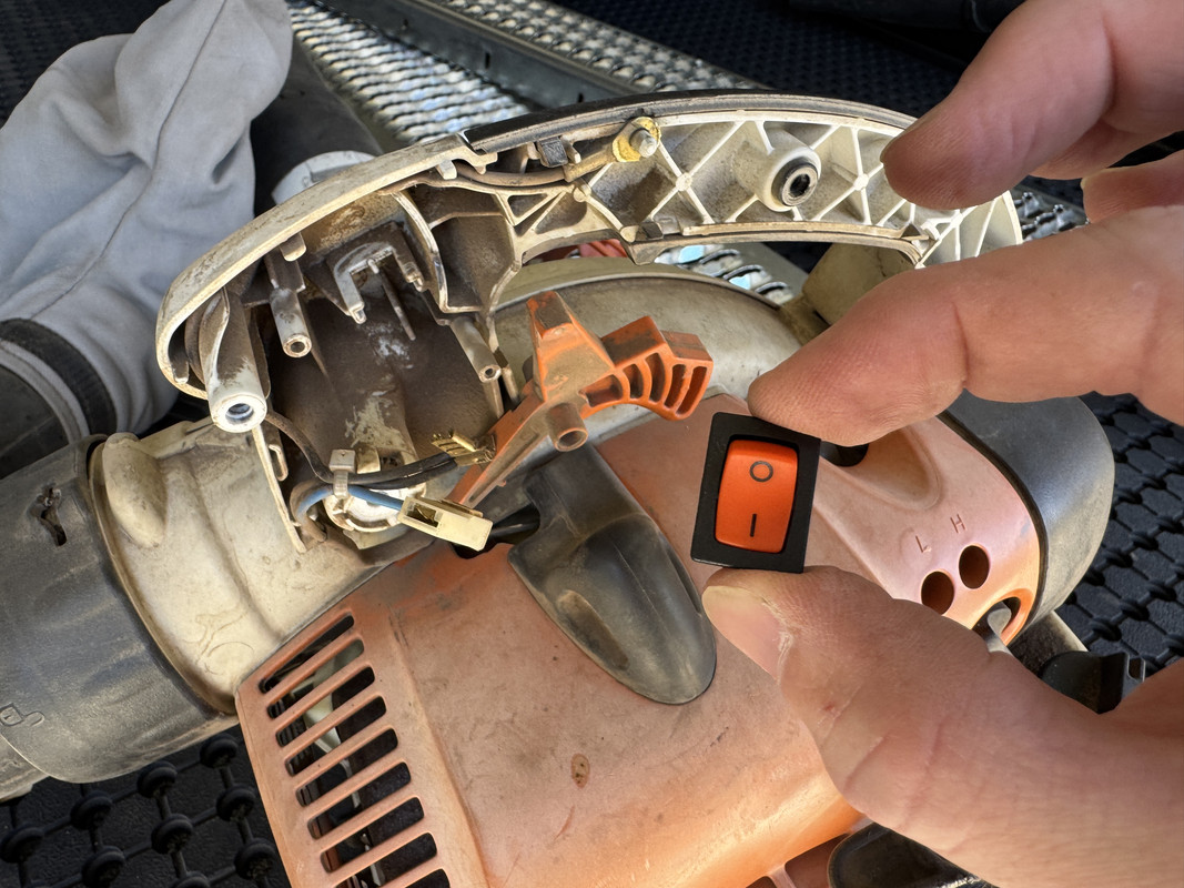

This Stihl BG86 I've had set up in vac mode for longer than I can remember. It's also had a broken kill switch for about the same period of time, I've been having to twist the choke switch to shut the engine off. I did make an attempt to fix the problem a few years ago but failed and ended up dealing with it. Considering my newfound confidence in repairing my own machines, I decided to give it another try.
I was fairly sure the problem was the cheap switch hidden within the upper handle. On the older BG 55, 65 and 85, as well as the later BG 56, that switch was situated on top of the handle and activated directly by the user.
These switches were a known failure due to dust entry, so Stihl started encasing them in a rubber shroud. With that, I assumed dust had killed the switch on this unit.
On the later BG86 models, that switch is hidden within the handle and is activated by pushing down on the throttle lock, which in turn presses on the ignition rocker switch.
I've previously tried fixing the switch by cleaning the connections and lightly blowing with compressed air. From memory, that fixed the problem, but only intermittently before it stopped working again. So, I went ahead and ordered an aftermarket switch from Amazon.
To gain access to the switch, you need to remove the four T27 screws from upper handle cover, separate the handle, then lift out the throttle/stop rocker. You can do this with the throttle trigger in place, but its easier with it out of the way and just slides off a peg moulded into the case.
From here, slide out the switch and disconnect the wires, keeping track which is which. The new switch takes its place.
Where possible, I prefer to use OEM parts, but it's hard to find them for sale on Australian webstores. No doubt these companies would prefer you to go to your local dealer, but with the problems I've had in that arena, I don't have the time or patience to deal with those clowns. I remember spending 20-minutes at the local Stihl shop trying to buy a very basic chainsaw fuel filter, in the end they gave up and said they'd order me one and call me when it was in.....................I'm still waiting for that call 4-months later. An aftermarket Amazon special it was then..........................
Firmusparts 4229 430 0203 On Off Switch 42294300203 Compatible with Stihl Trimmers FS38 FS45 FS46 FS55 FS56 BT45 BG45 BG46 BG55 BG56 BG65 BG66 BG85 BG86 SH55 SH56 SH85 SH86 4229 430 0202 : Amazon.com.au: Garden
Stihl - 4229 430 0203
With the cover reinstalled, I fired it up and..........................it still wouldn't turn off without the choke. :confused:

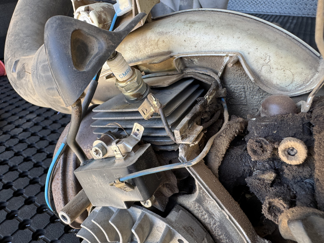

After some more research, it seems these blowers have two know ignition-cut problems. So, I removed the handle cover again and found the problem..................broken kill wires. I assume age and heat cycling causes the wire to crack, then separate. So, I went online and found the OEM replacement kill wires. A week later, it was time for attempt three................
Wiring Harness for STIHL BG56, BG86, SH56, SH86 - 4241 440 3000 | eBay
Stihl - 4241 440 3000
For this repair, you also need to remove the recoil cover, which is held in place with three T27's and the spark plug boot. The function of these wires is to provide a ground, then link the kill switch to the coil.
To keep track, I started with the ground wire, which is mounted on the upper handle, then traced back to the kill switch, disconnected old and connected new, then traced back to the coil making sure to hook it up the right way around. The wires were then tucked into place and the covers reinstalled.
This is the old loom, which had severed where it makes the 90-degree turn towards the coil, it shouldn't be in too pieces.
Everything back together, I fired it up and was rewarded for efforts, the engine now shuts off with the kill lever. Probably a waste of time and money on a clearly aged machine, but I at least know how to do this job. ;)
