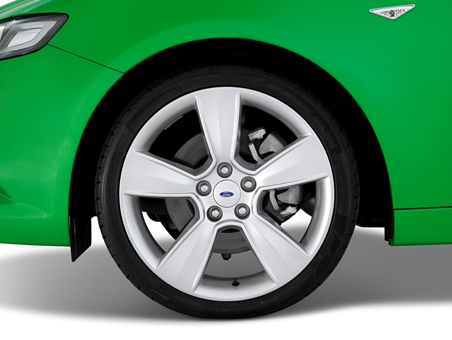

I'm shocked at how small your brakes are Deyon, especially for a heavier car like you mentioned. For comparison sakes, my EN weighs 3200 lbs and has 14.2" front brakes and 13.6" rears. Although not Brembos the front calipers are pretty big, maybe off of one of their larger SUV's, maybe not and the pads are aggressive, so when it comes time for pads, I'll be getting some carbon ceramic replacement as I don't track my car.

Yep, way small. My XR6 has a listed curb weight of 1728 kg or 3809 lbs.
The brakes look even worse if you ordered the 19-inch wheels!

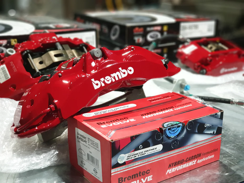

The above is about as far I can upgrade without changing calipers too, which is technically possible. I would LOVE LOVE LOVE to put a Brembo kit on this car, but I would need new wheels to go with that.
The actual wheel diameter is not the problem, Ford did use 355mm rotors and 4-piston Brembo's with 18-inch wheels on selection of models, but rather the back of the spokes are not dished out enough to clear the front of the caliper. Then adding up the price of a full Brembo 4/4 piston caliper/rotor/pad/brake line set, then adding the price of new wheels and tires would approach half the price of the car itself. I like setting fire to cash, but even I have a limit.

Those Brembos are nice, no doubt but had you went with them what color would the calipers had been

The red would look great against Sensation Blue, but I would have gone with the black versions for a more subtle look.
