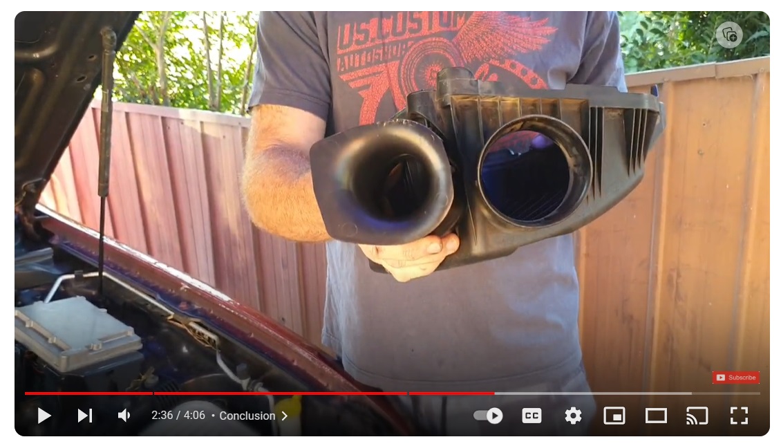

For the record, early on I tried removing the intake restrictor but immediately put it back in. At the time I remember searching for information on this apparent "free mod" only for me to discover what I felt was actually true.
That intake insert was intended to increase air velocity, in the process bolstering low-end torque and further tuning intake sound quality. So, while it has the potential to deliver more air to the engine and increase the volume of the induction note, the benefits are only felt at the top end of the rev range, while also delivering less favorable resonance. If you were racing the car, fine, take it out. But driving the car as it was intended, with the occasion run to the red line, leave it in.
This is a more technical description of what's happening I found on another forum -
"......more velocity = better atomization = better mixture distribution in the combustion chamber = better combustion = better volumetric efficiency......"
Strangely, there doesn't seem to be much imagery online about this part of the car. I lifted these shots from the video I'll post below -
