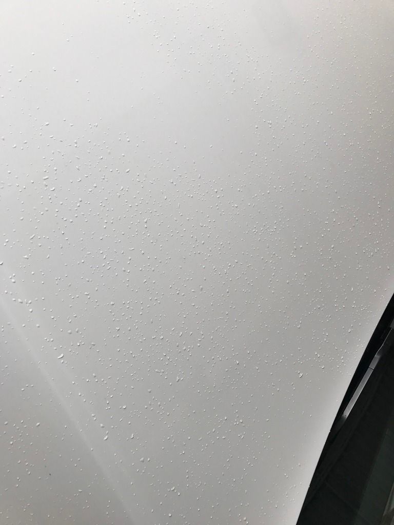

After wash applied Reload, the directions are vague on the bottle, so I took the same approach as I did with CQuartz UK a little goes a long way. Sprayed direct to clean cool paint in the garage and buffed off. Now it rained today and the water was just kind of sitting on the paint, had some time on lunch so went down the highway to see if the 70mph sprint would maybe push the water off....NOPE!!!

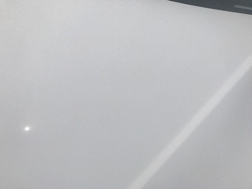

Its hard to see but there's water droplets everywhere on the entire surface of the car
And willsports had this comment on my show and shine thread. Was he right? Have I screwed up the coating? I feel he's onto something as its obvious before I applied Reload the coating was shedding water like crazy and now it's sitting. I'm not gonna lie, pretty upset right now especially since I spent 3 days getting my paint ready for the coating only to be horribly let down after applying the company recommended after wash product.

Well I literally just took it to a car wash and hit it with the clean water pressure washer and again same results.

Better picture
