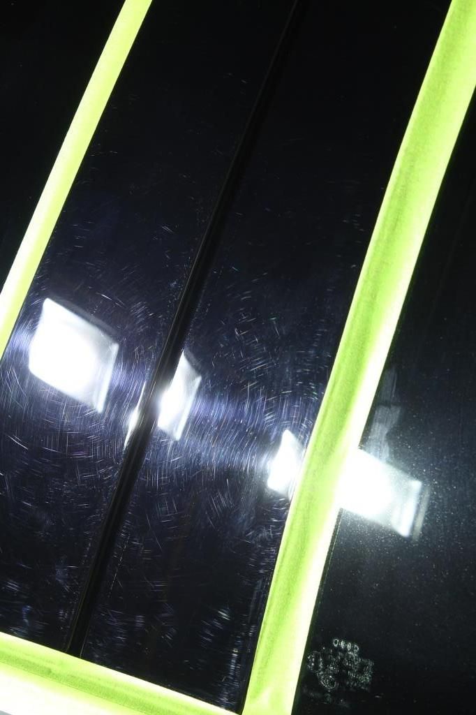

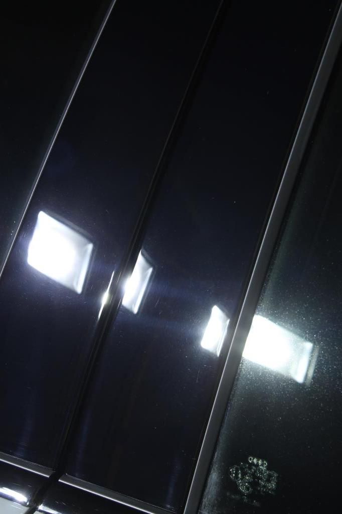

If nothing else comes from this thread, I hope you will at least see how quickly improper washing and drying can mess up your car. This beauty only has 1200km on the clock and could only have had a handful of washes.... but look at the damage already inflicted.
The worst of it was on the softer B-pillars but even on Audi's very hard paint, the swirls were starting to show

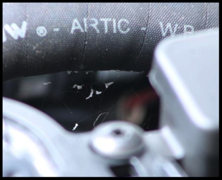

As always the engine bay was first. It only had some light dust and dirt
And some cobwebs :lol:
Everything was blown out, then wiped down with mf towels and Carchem APC followed by a damp MF wipe down, the dressed with Autofinesse Dressel. Forgot to take any after pics :oops: sorry :fear:

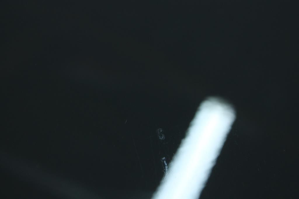

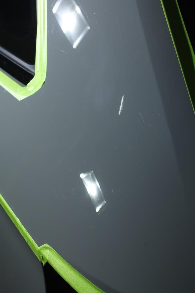

With the paint now 'bare' it was easy to see the swirls from poor washing and drying there were also a few bird dropping etchings on the bonnet. You can clearly see the deeper scratches close to the etching where someone has obviously tried to rub the bird dropping off the paint - you should instead try to 'lift' the dropping off the paint.
Paint readings were taken (all in µ [microns]) and as you can see the bonnet was significantly thinner than the rest of the car and so aggressive correction to remove the bird dropping etchings was simply not an option.
After a few test spots I settled on Menzerna PF2300 on a Orange Lake Country Hybrid pads for the correction work. The car is full of really sharp body lines which meant I used just over 2 rolls of tape during the detail and with all the awkward angles, the newer shape RS3 is a fair bit more difficult to correct than the old shape.

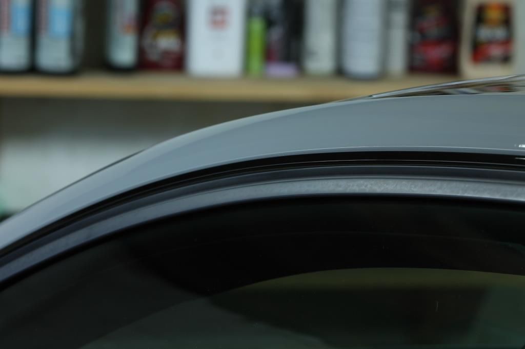

All the rubber were cleaned using Shield Heavy Duty rubber cleaner
Then protected using Optimum Optiseal.

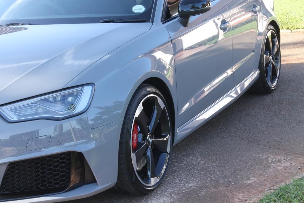

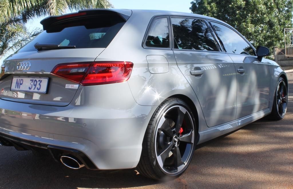

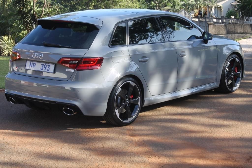

Here are some after shots
I must say I really fell in love with this color over the time I spent working on the car :drool: Not only does it really have some life in it for a grey, but it suits the lines of this car so well.
