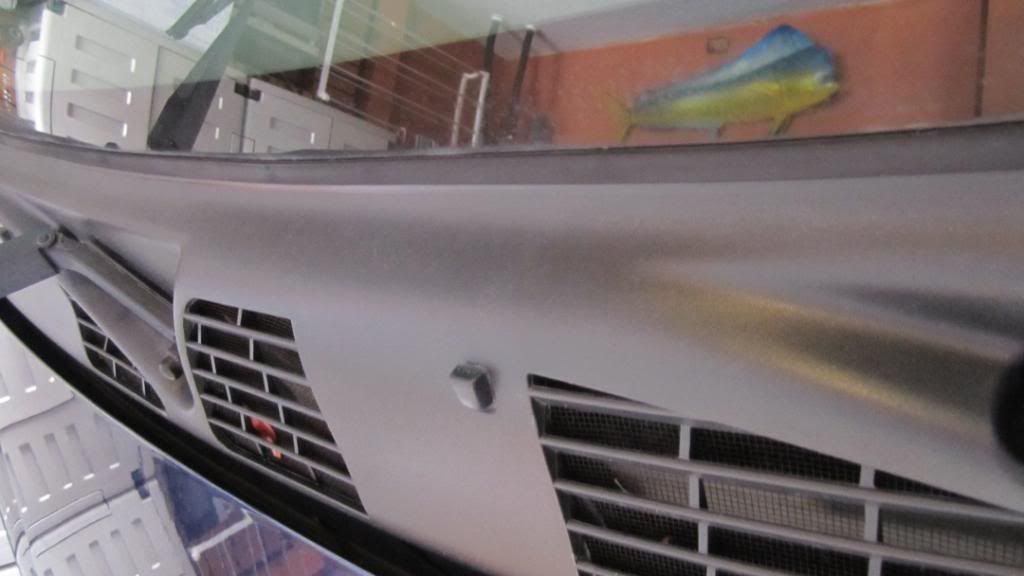

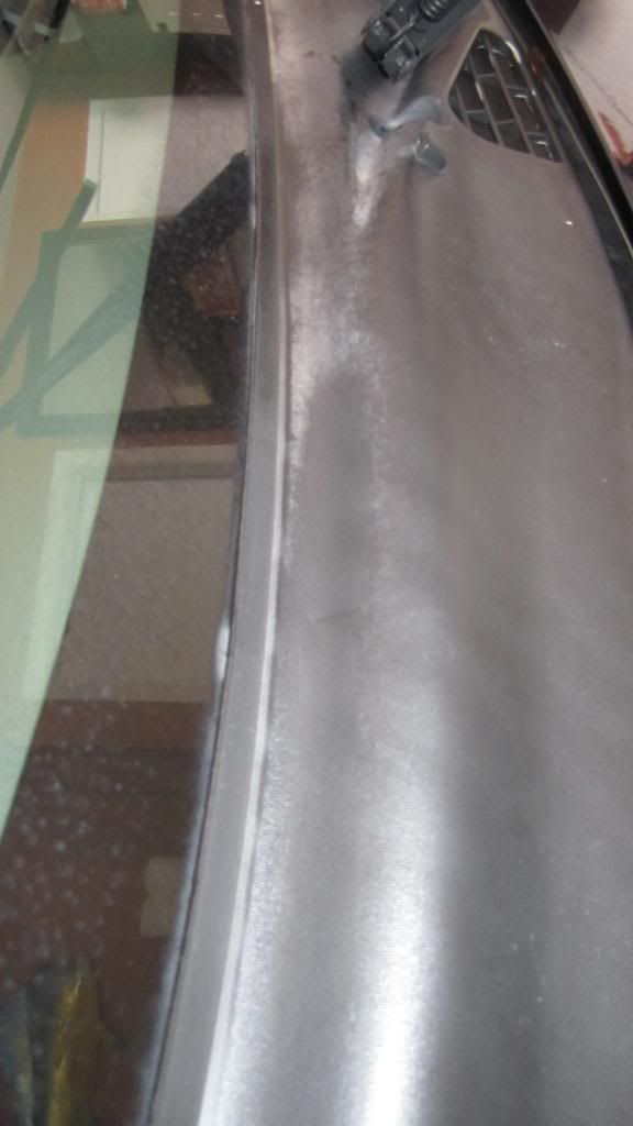

No i was claying fine. the car is a 2003 thats been outside its whole life and never been clayed and only waxed once.. heres some more pics of the front window cowl that was stained..

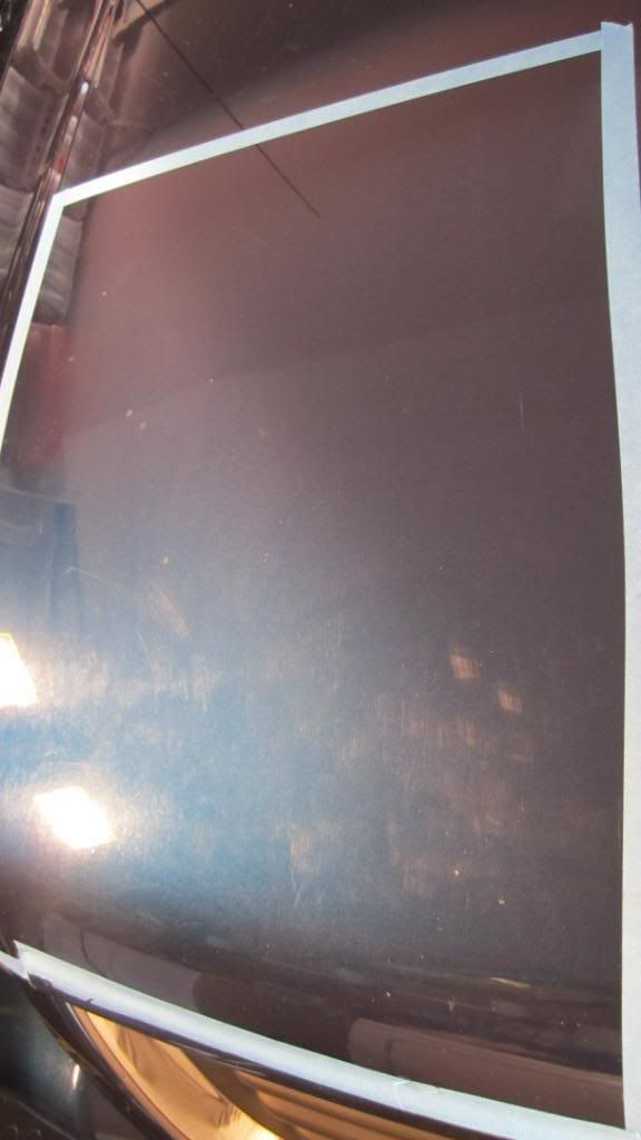

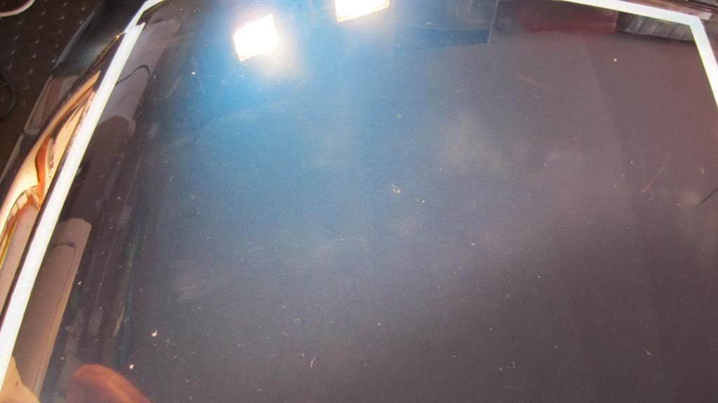

setting up my test spot.

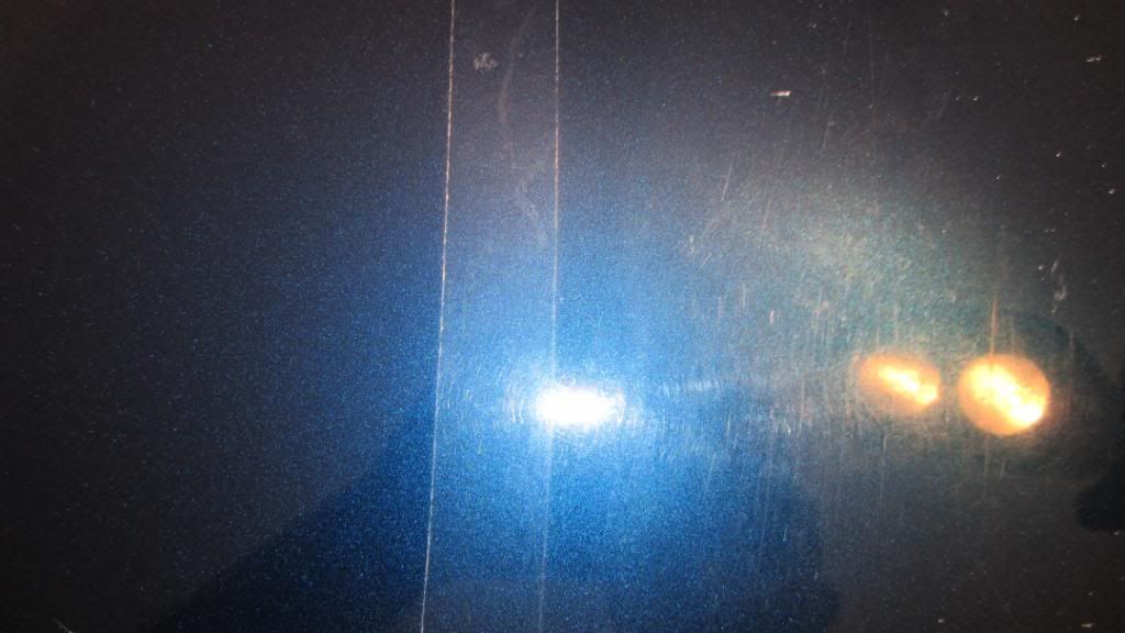

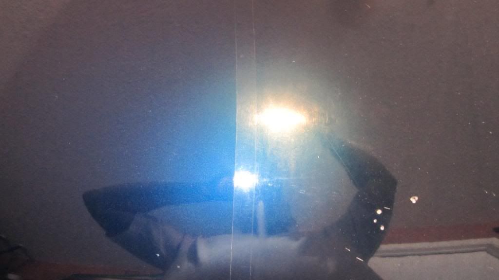

see that scratch on the right I wet sanded it down and compounded with m105 on a purple foam wool pad followed by mf cutting disc with m105 DA and a white lc flat pad DA with SIP
50/50

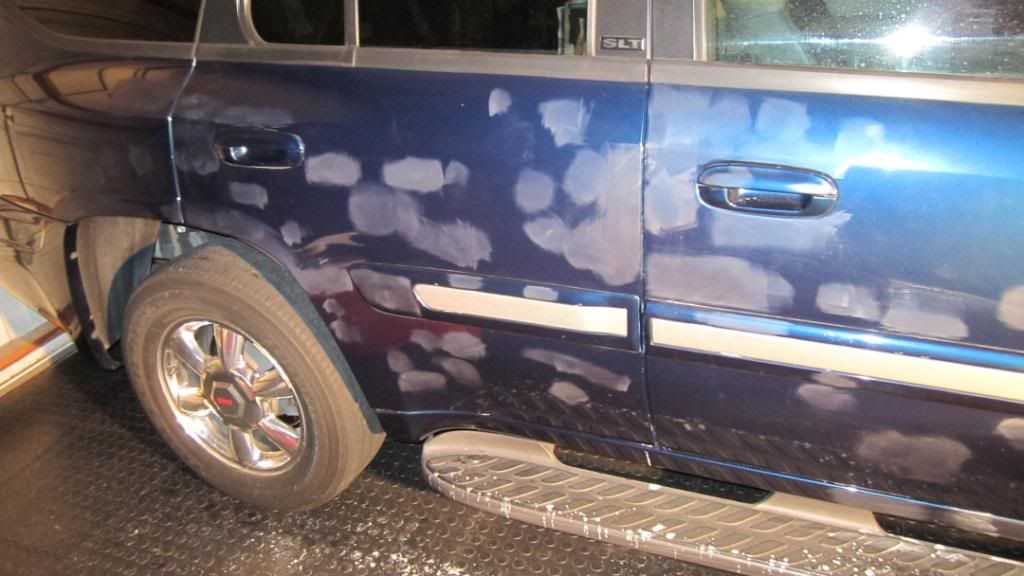

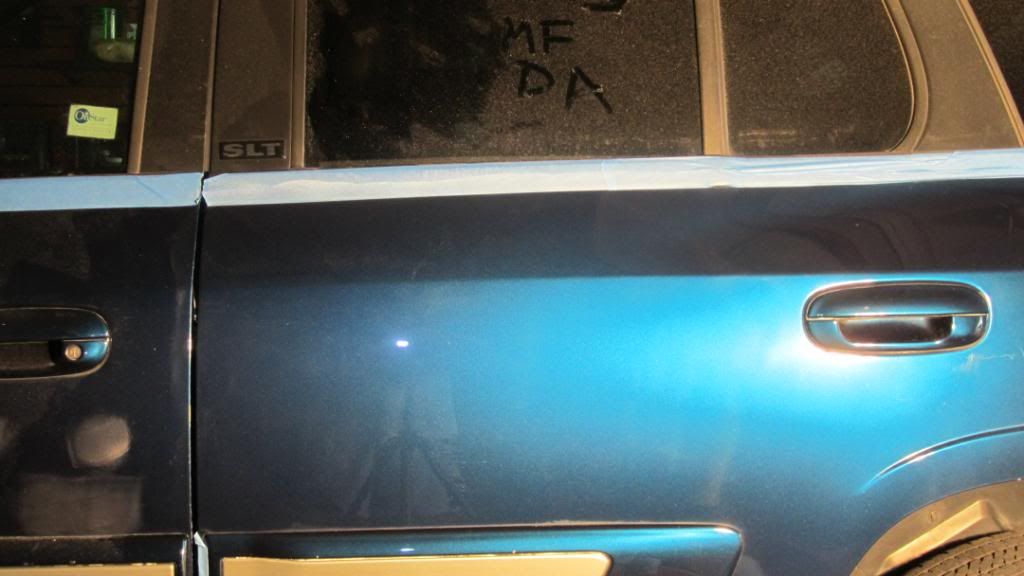

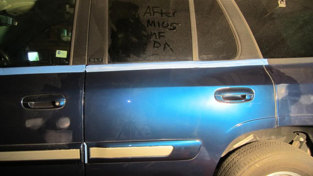

this is where I wet sanded 2500 grit (spot sanding all over the door) and hit it with the mf cutting disc with m105 in DA which DID remove the sanding marks with no problem.

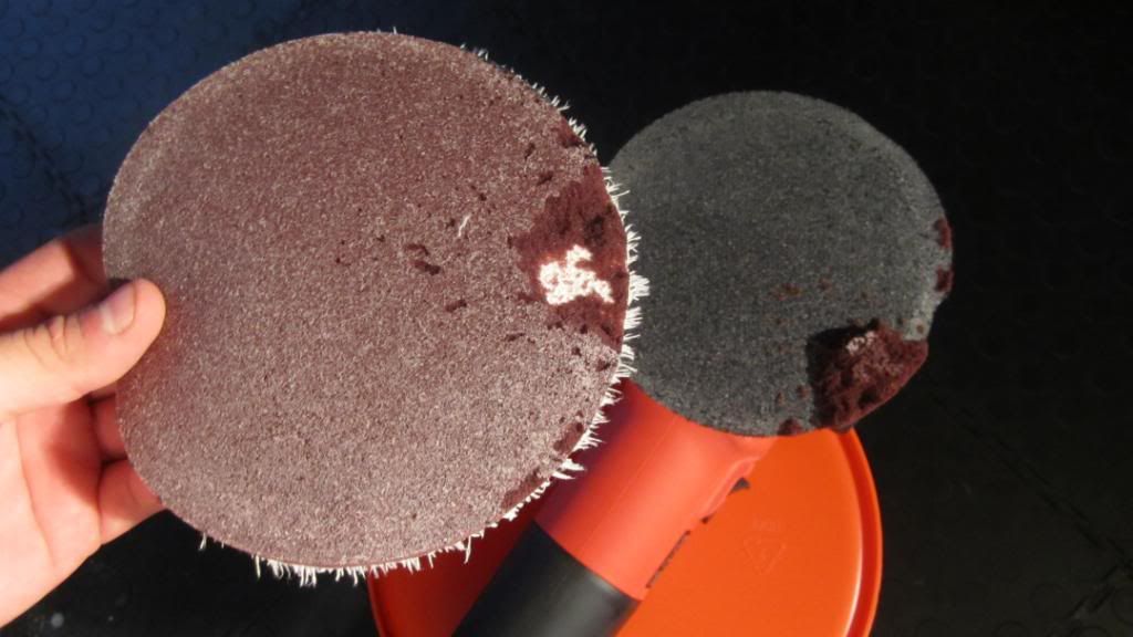

This is my mf cutting disc after doing the hood, driver door and driver side rear door :( Very disappointed as i have seen this happen to quite a few people.
50/50
First off...nice job looks really nice so far...second of all...thats a lot of dust on the window...is it dirt or just dust from 105?
Lastly...it looks like you have a Griots...I've had the pad separation problem as well...but i dialed down my griots to 5 or 5.5 rather than cranking it at 6 and still got excellent correction and my pad did not over heat. What i'll do about 1/2 way through is...take a break...not just for me but for it...i'll do the tires or go get a drink or something...just easily pull the pad away from the plate so it can air out...it helps.
I still feel the damn glue on these things should NOT melt under the heat...on speed 6 or not...but it is what it is so i dialed down my speed...i'm HOPING you were using it on 6 lol. Plus i think that D300 says to be used on like speed 4 if im not mistaken.

will I have taken out the 2000 grit marks with the mf using m105. I was using it on speed 5 the whole time :) that is dust on the window from m105. and thank you will its alot of wetsanding which take forever by hand when your a rookie at it because I have stronger grit papers bbut im not going lower than 2000 grit, which i am making a few passes on it which leads me to think why not use a lower grit less passes... but as for now, I have no PTG and its my first time . Regardelss of anything this car will look WAY BETTER than what it did..

Wow...then that sucks that the pad still came apart...maybe a little less down pressure? I use to really lay on the machine ...not so much that it wouldnt turn...but id have it down pretty hard...i lightened up some which helped lessen the heat build up...just kidna had to tweak my process....ive done 3 polish outs or so since i changed my process...and was able to make it through an entire car, truck and SUV with one pad...the same pad infact...with zero problems so far. Now it was a LC Flat polishing pad..but ive had LC Hydrotech and Megs Soft Buff 2.0 come apart on me...but again i was using more down pressure then and cranking it at 6 everytime. If i hit a bad area on the car...i'll kick it up to 6...but i try to stay conscious of how often i do it and try to give it time to cool down.

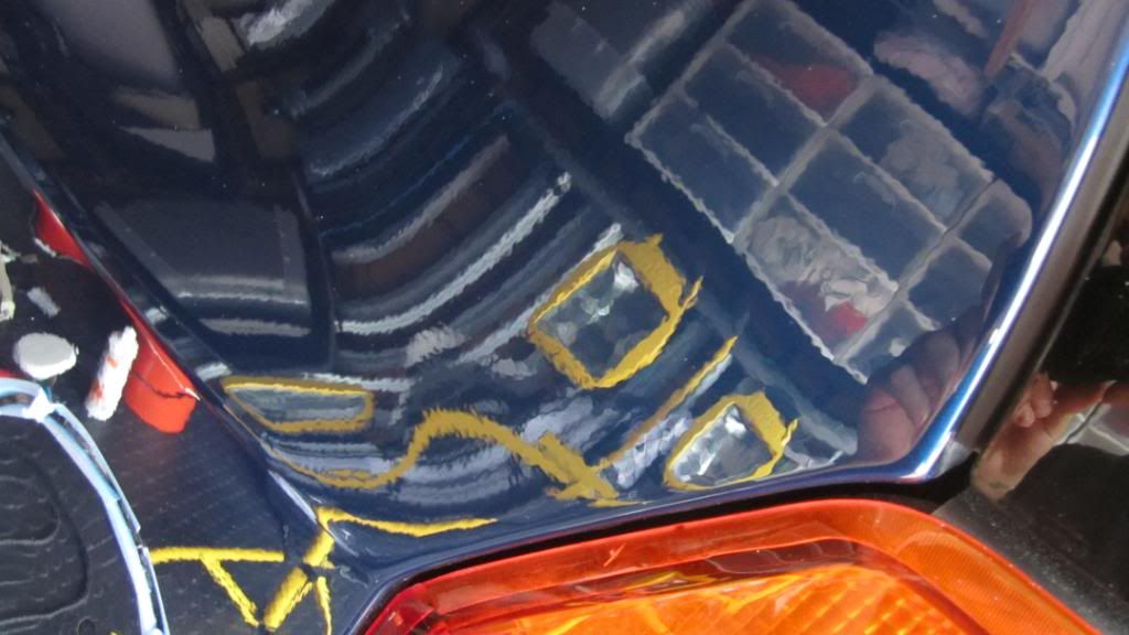

used m105 and menz sip and this is what im ending up with :)
i believe this has orange peel look at it closely

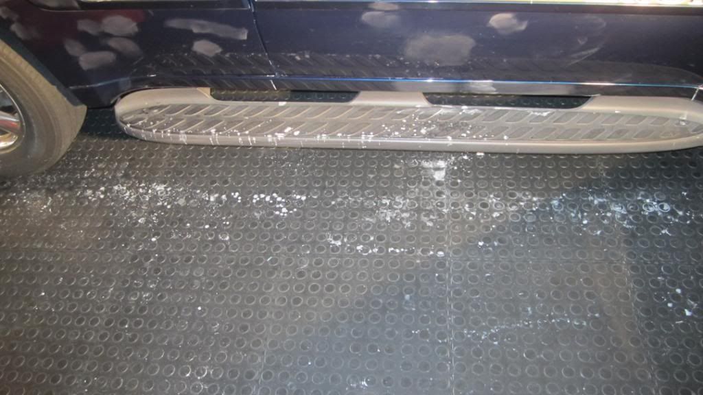

clear coat on my floor!
