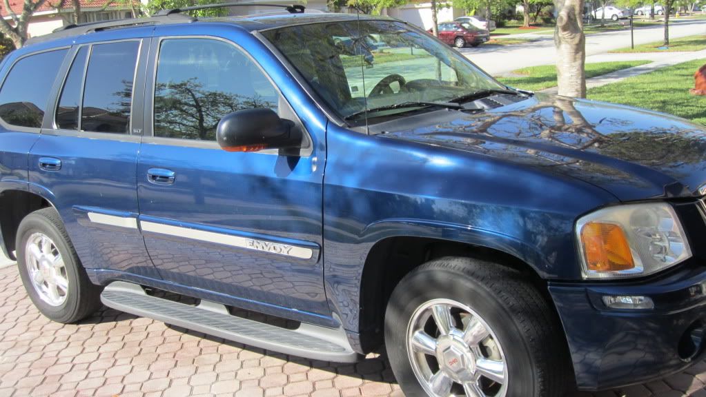

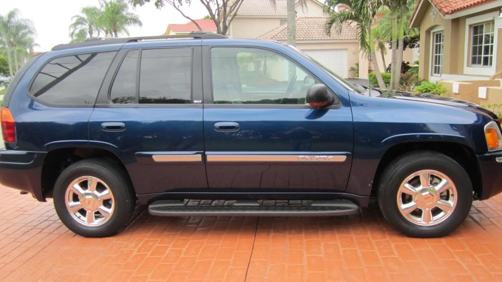

this car is in the line up for paint correction

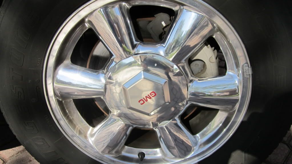

A: Put a small bead of paint polish or rubbing compound on a towel and work it by hand on a "test spot" on the (cleaned) wheel. If you see black residue coming off onto the towel, the wheel is not clear coated and you can move on to a metal polish. If there is no black residue, you have a clear coated wheel and should proceed using paint correction products.
Shiny, I did a spot with m105 on the wheels and the black residue was coming off so I guess OPT METAL POLISH IT IS!!! :)

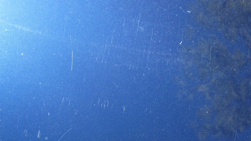

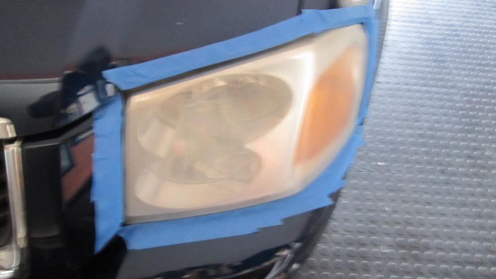

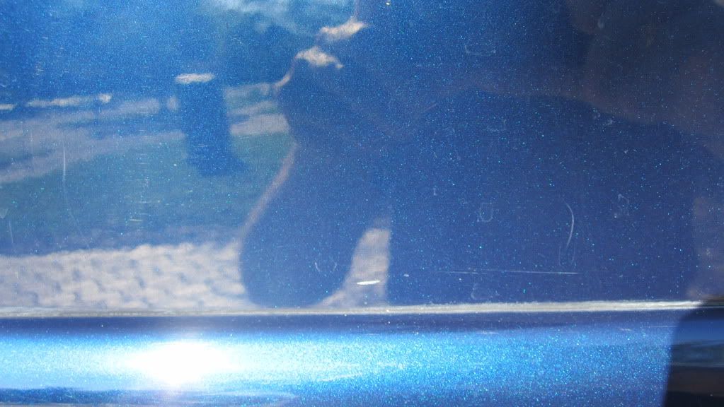

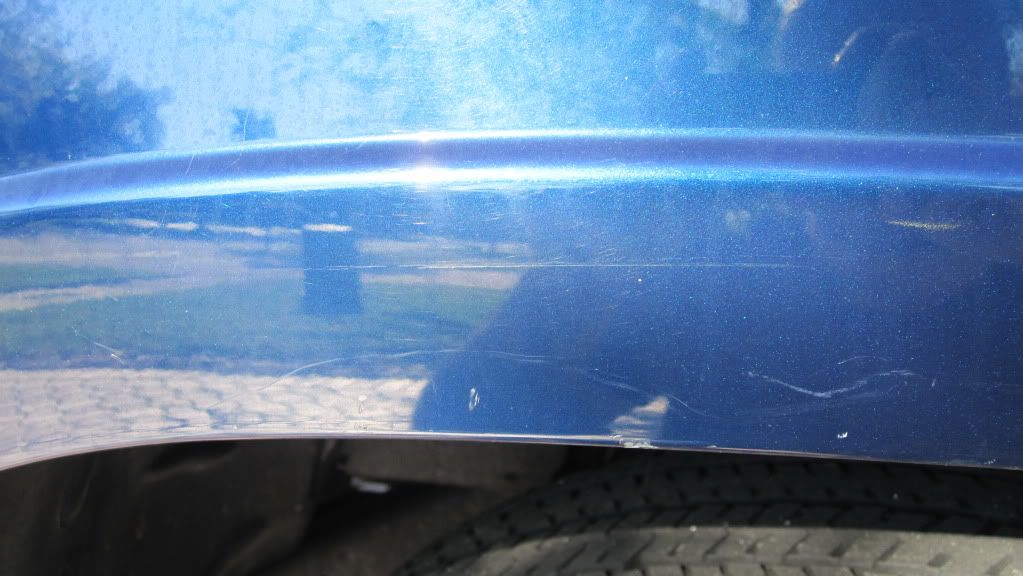

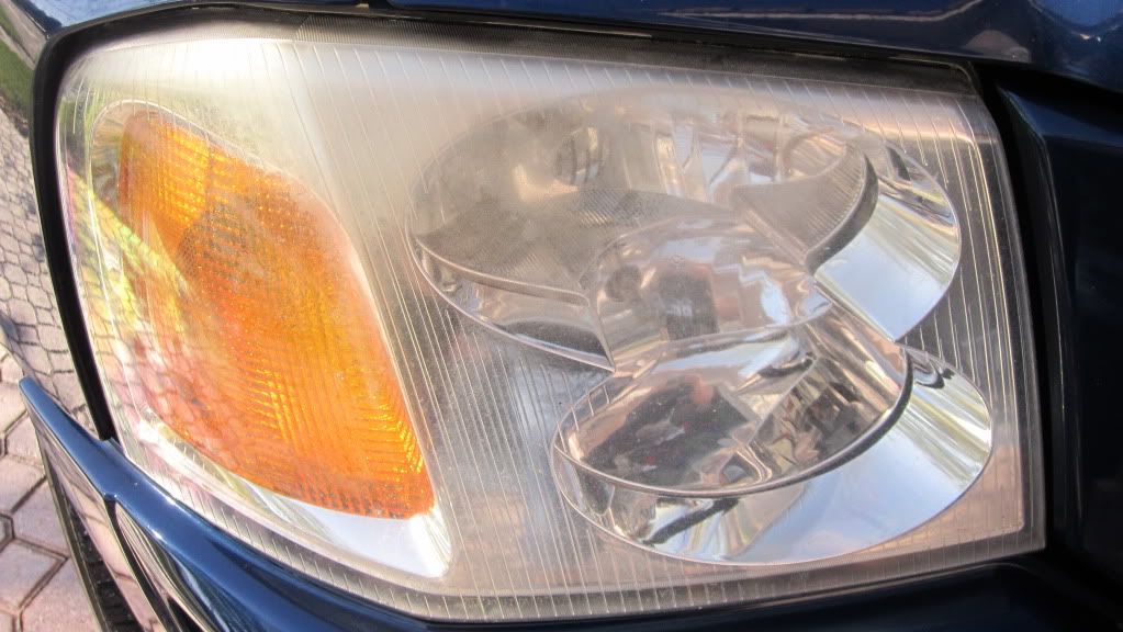

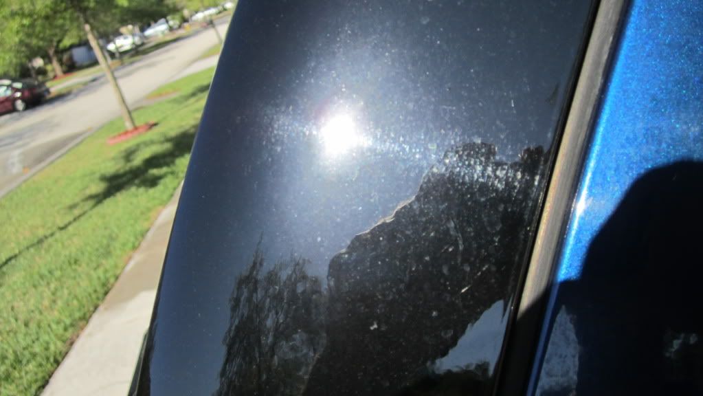

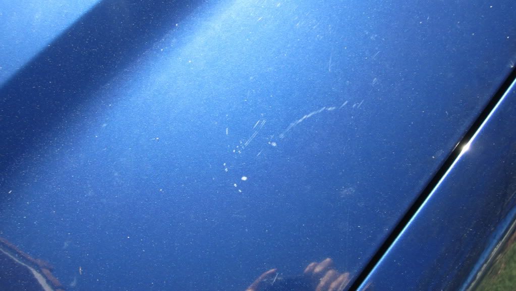

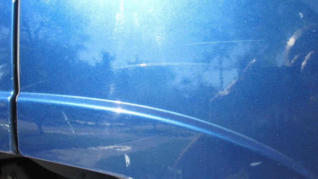

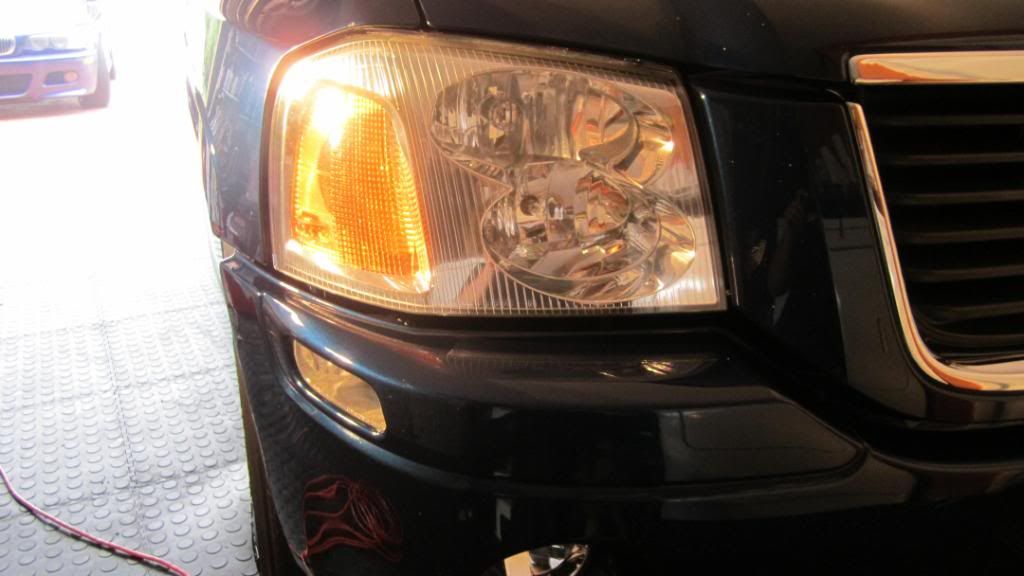

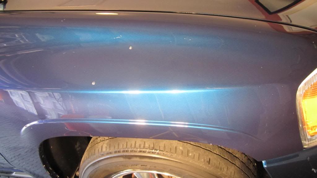

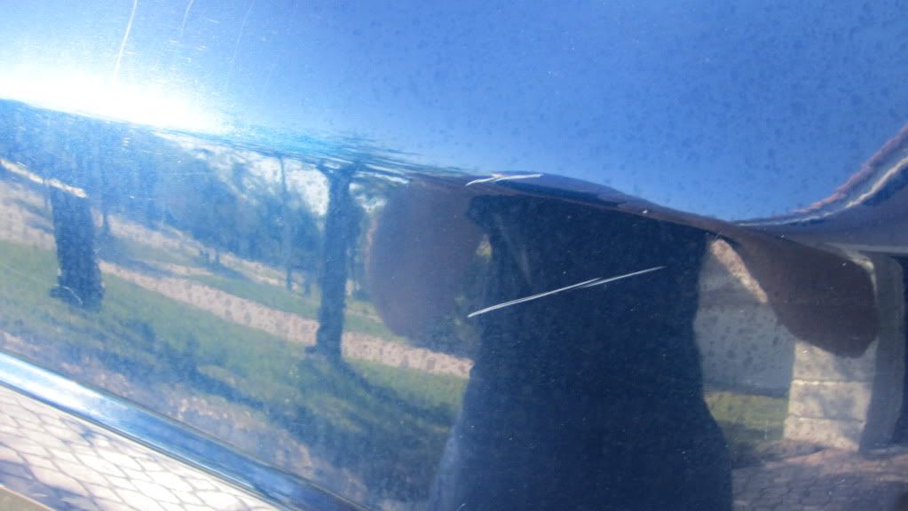

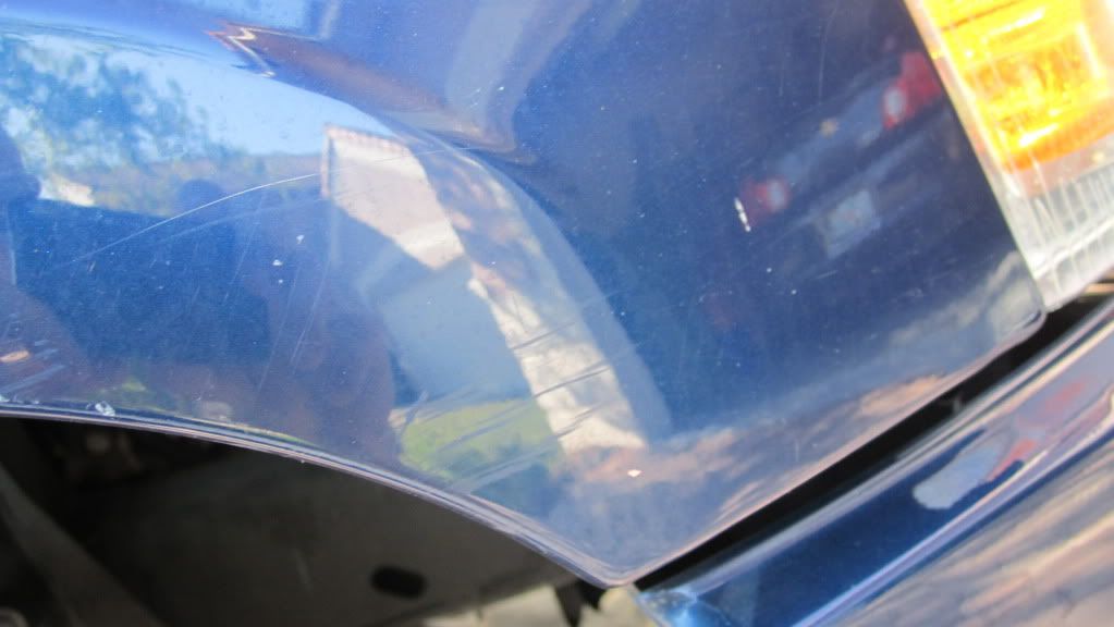

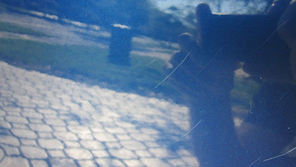

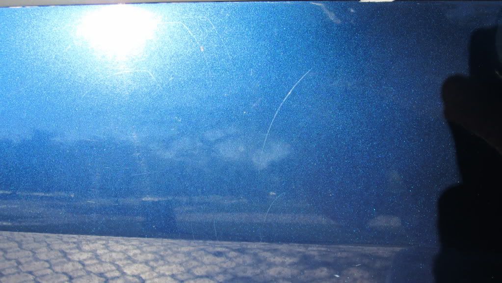

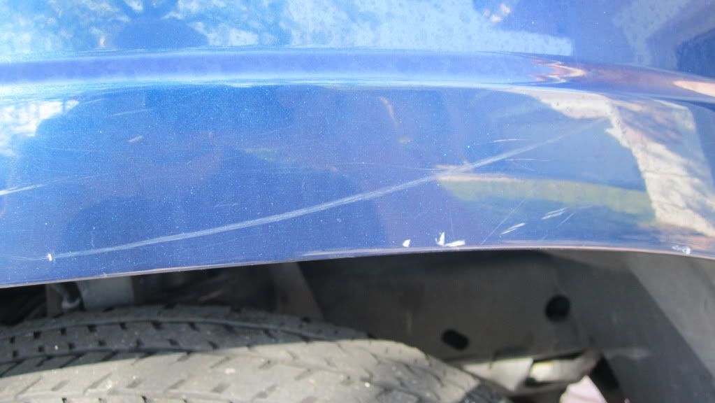

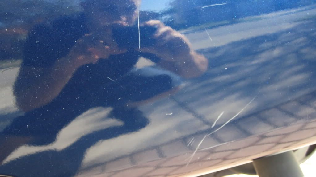

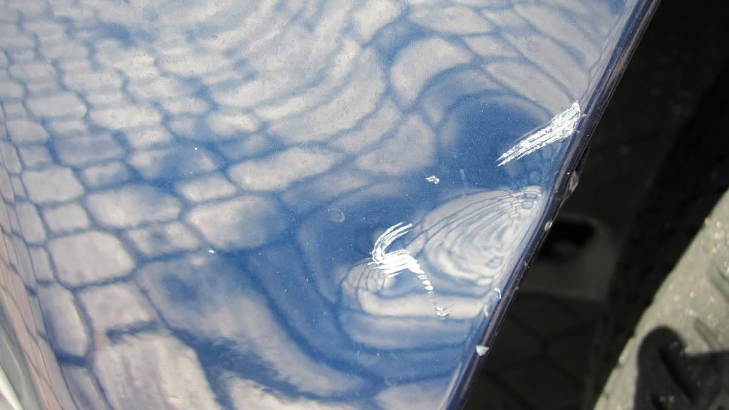

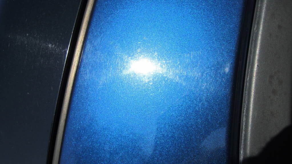

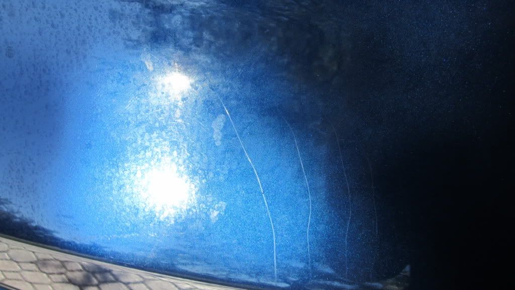

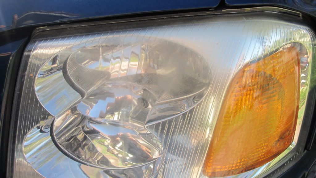

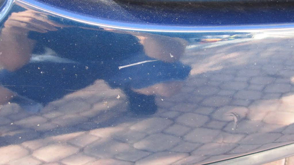

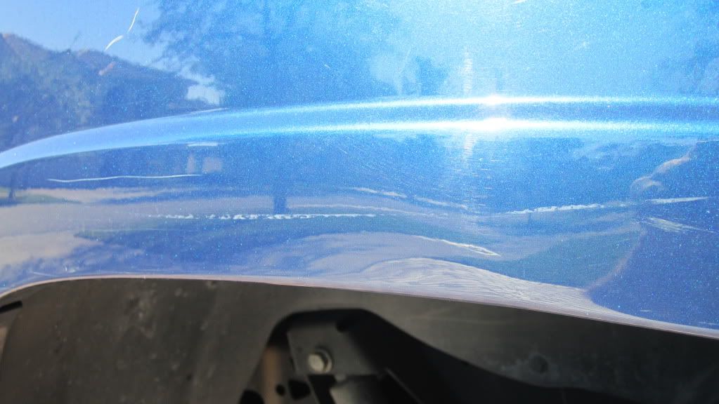

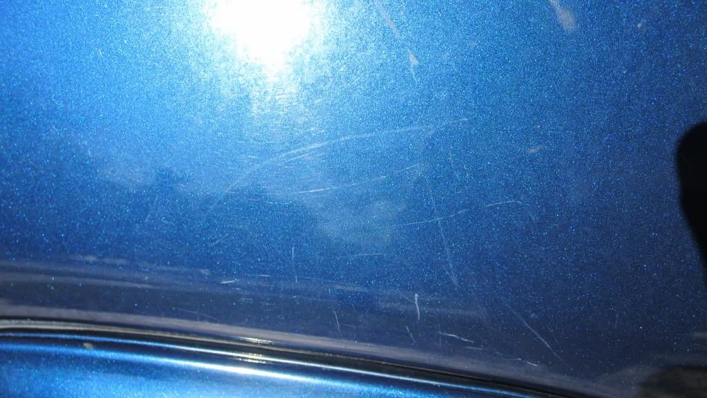

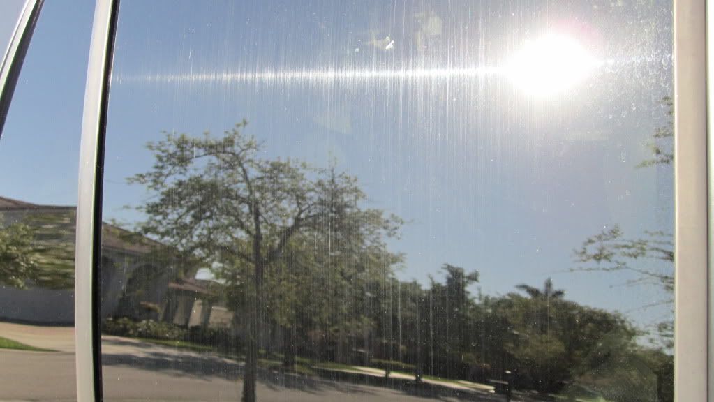

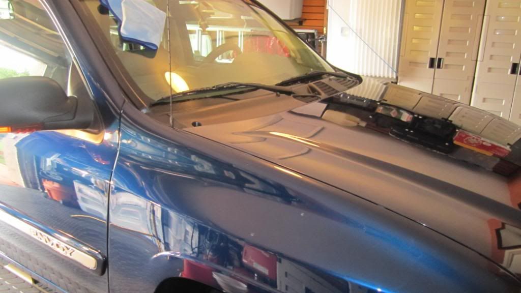

I am finally done, It took me about 35 hrs by myself BUT I still need to throw a sealant let that dry and cure then top it off with a wax, polish the wheels, and apply UTTG to all the trim. I wet sanded most of what needed to be wet sanded (about 60-70 scratches) with 2000 grit and some with 1500 grit. I did it by hand using a backing for the paper along with megs unigrit papers (kinda wear out fast). Needless to say the car is covered with orange peel from front to end and I wasnt about to do that by hand (meaning not using either a air sander or my da. Can a rotary be used as well? I definitely learned alot with this car "FIRST time sanding" and I felt very comfortable doing it. This car had some VERY stubborn WATER SPOTS EVERY INCH OF EVERY PANEL and it was swirl ridden and scratch galour EVERY where. The headlights needed some TLC as well which I did take care of that. The windows Had the same water spots as the body panels and I tried SIP with a white pad and that did nothing to them and Im not sure if a orange pad with SIP would be TOO aggressive so I didnt attempt it I will leave it for another day. Overall it came out GREAT! PICS will be up soon after EVERYTHING IS FINISHED looking like thursday morning I will be taking final shots and a final video of it along with a good write up. Thank you all who have helped me out along the way I really appreciate it.

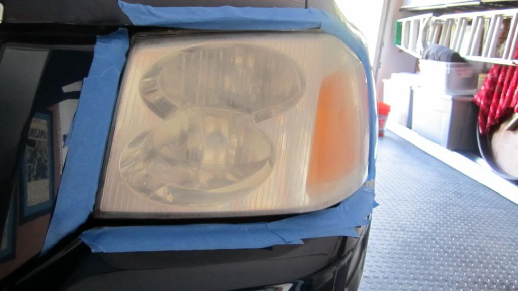

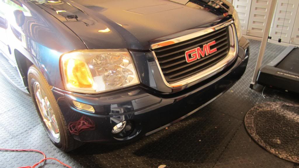

Heres the headlight sanded down pics of it done will be up tomorrow.

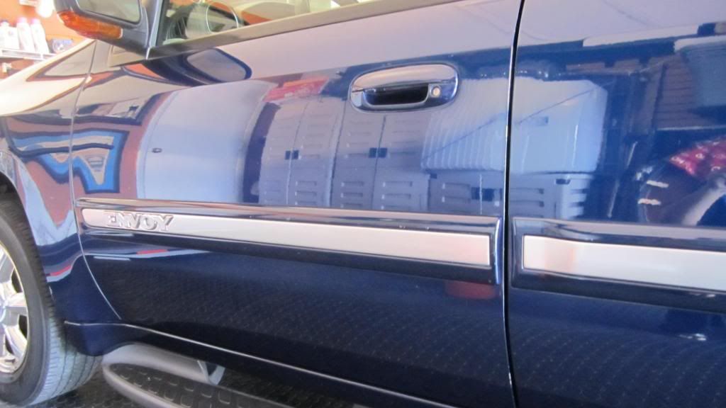

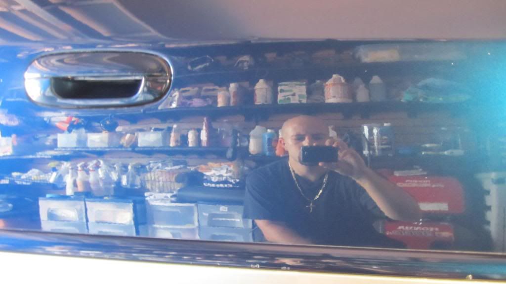

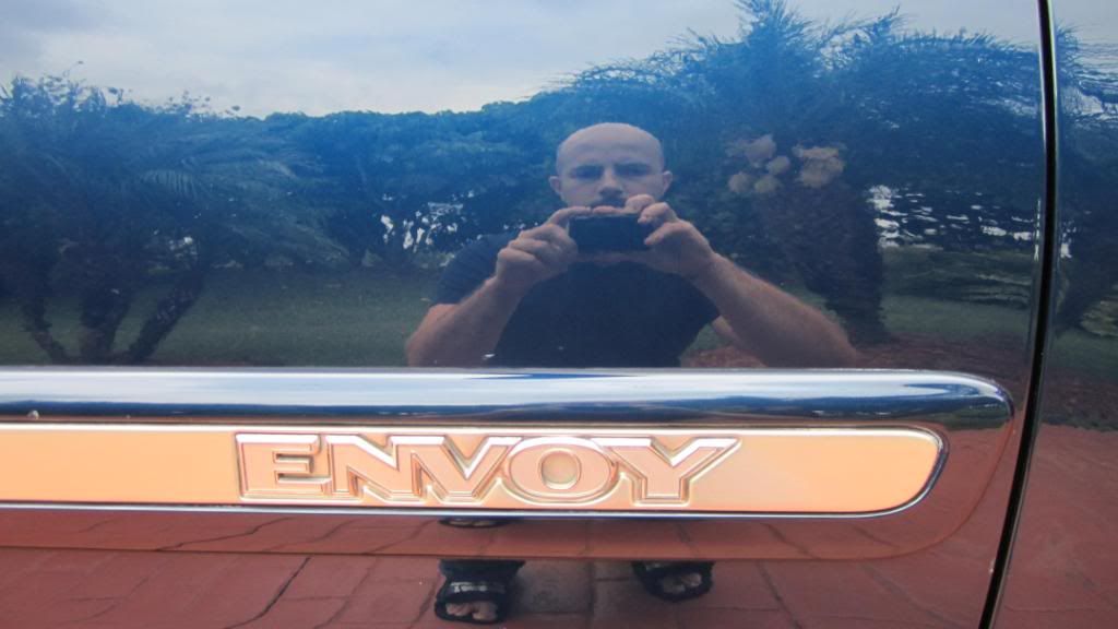

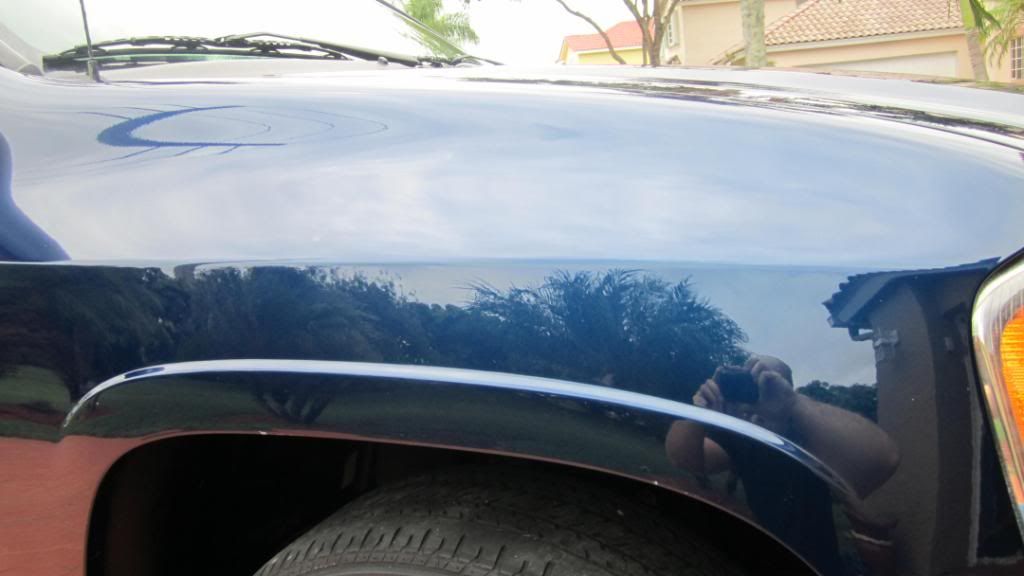

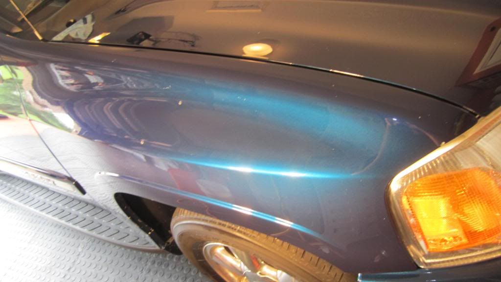

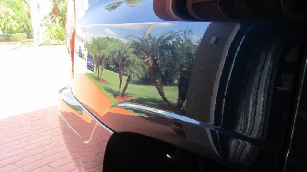

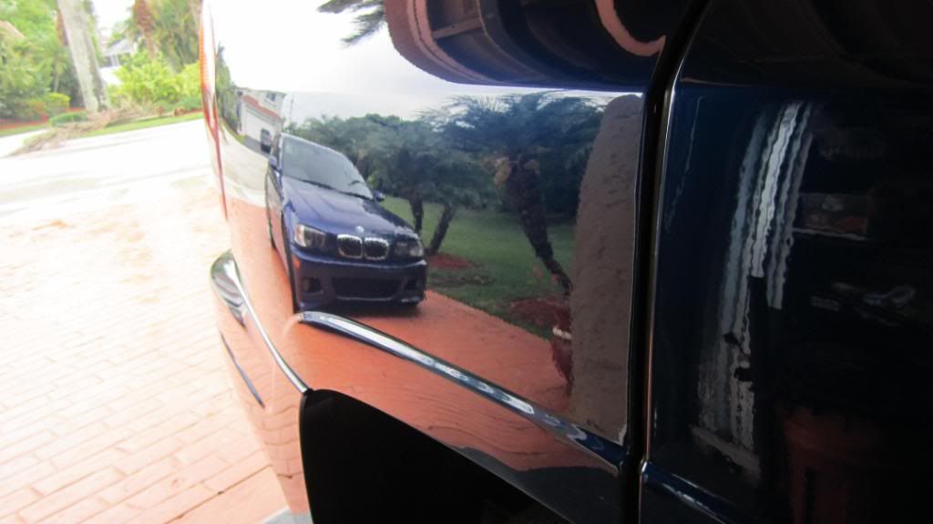

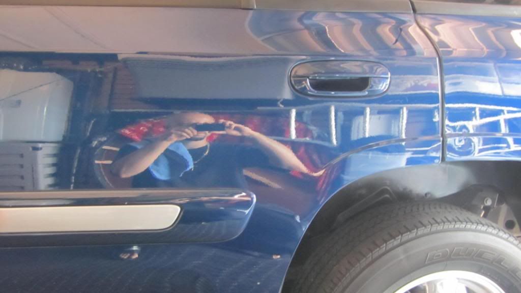

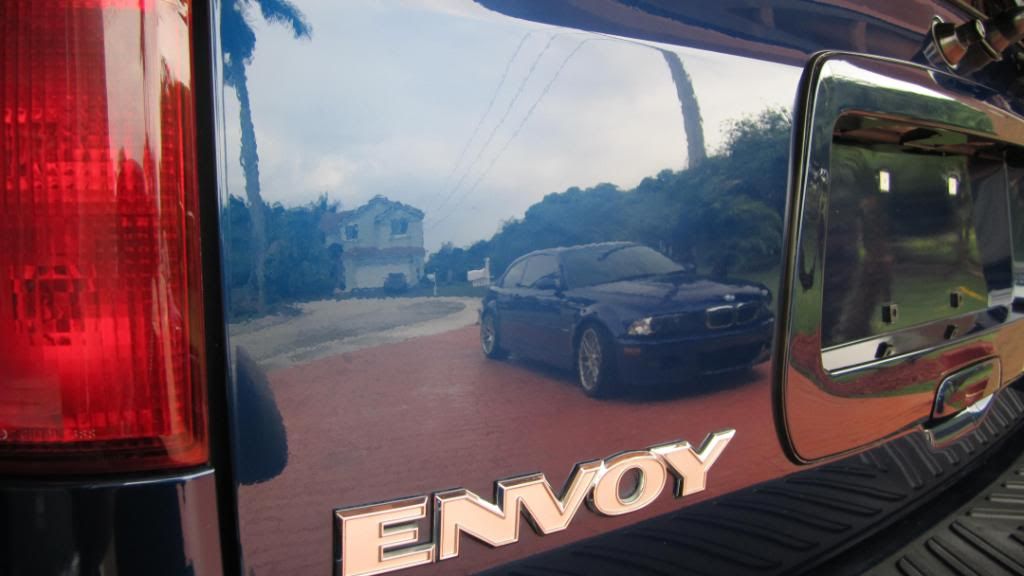

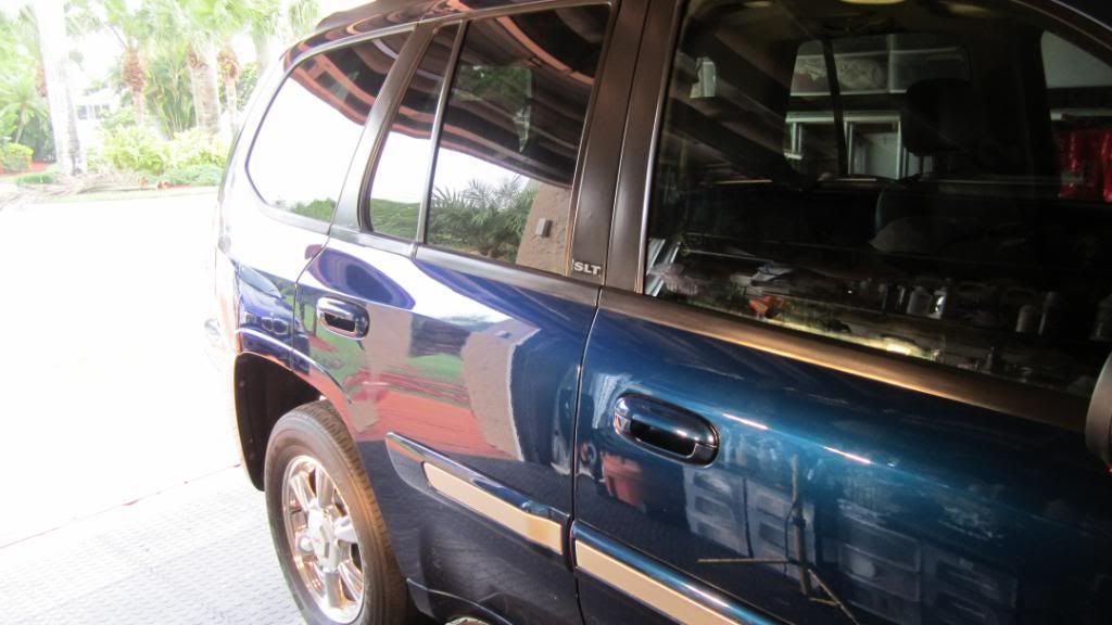

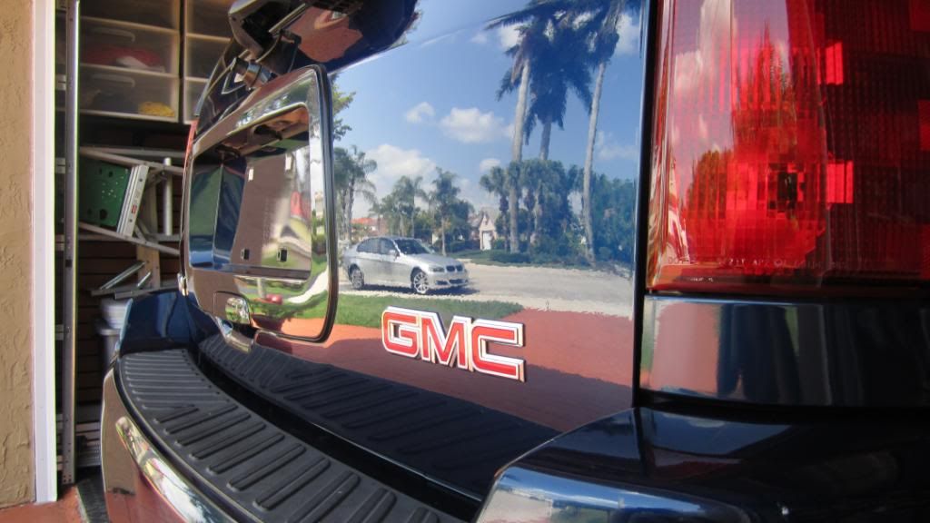

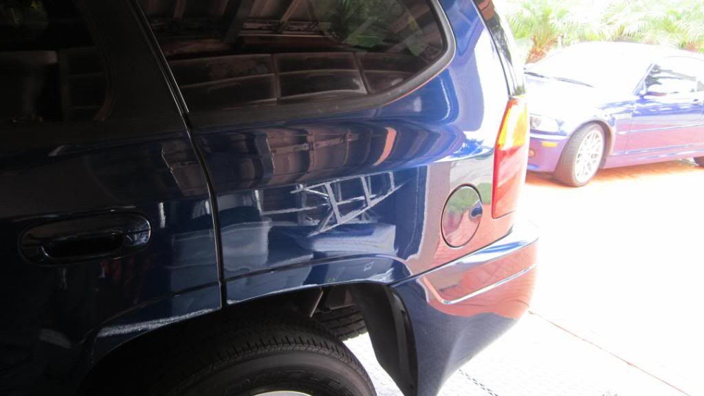

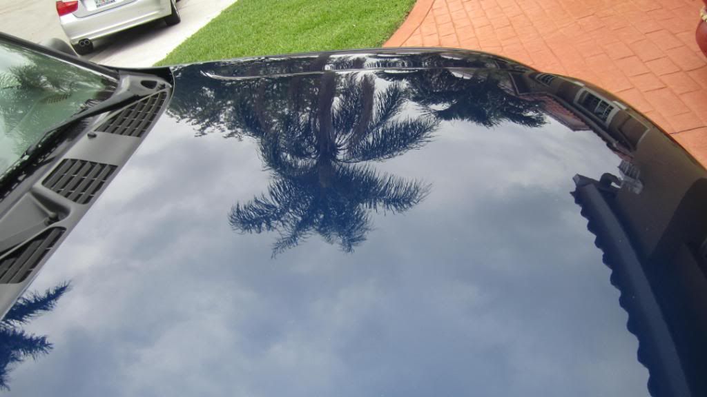

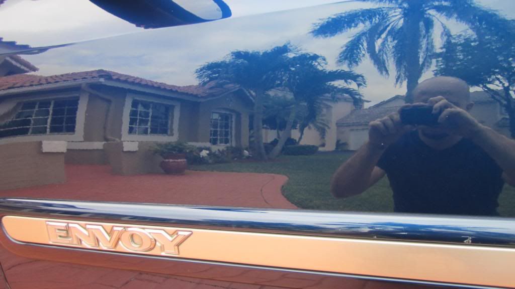

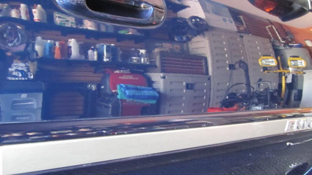

rear passenger side panel reflection shot AFTER SEALANT

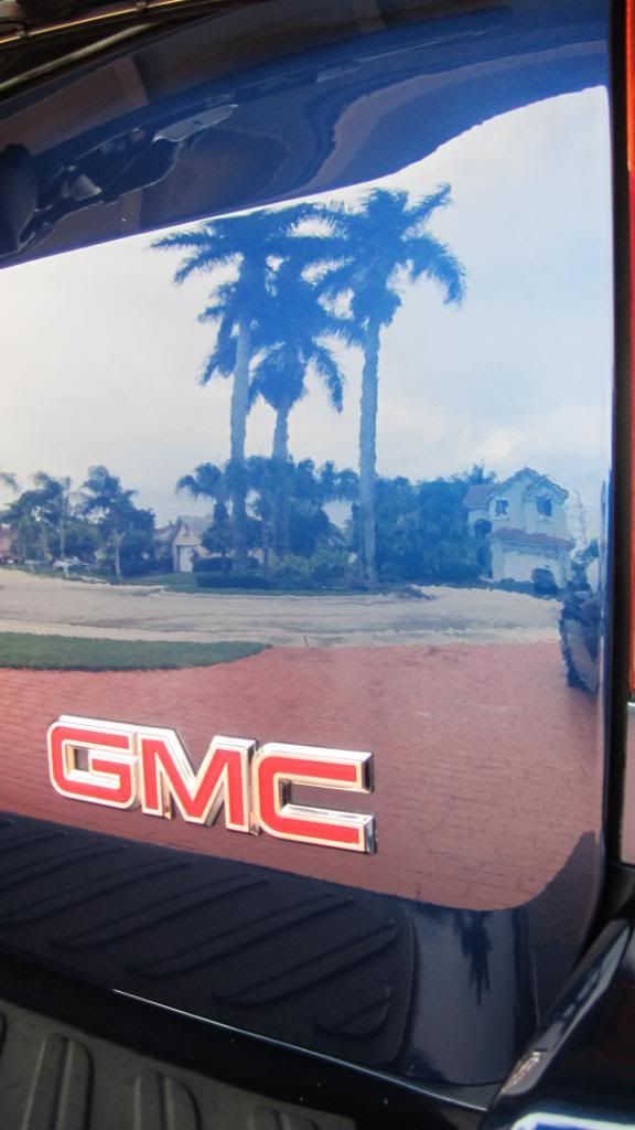

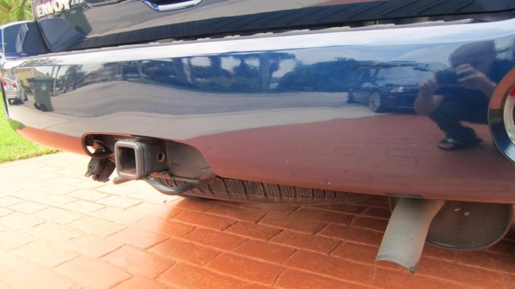

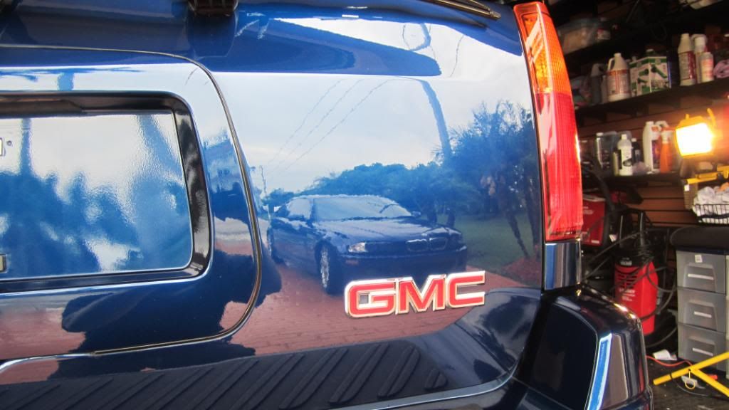

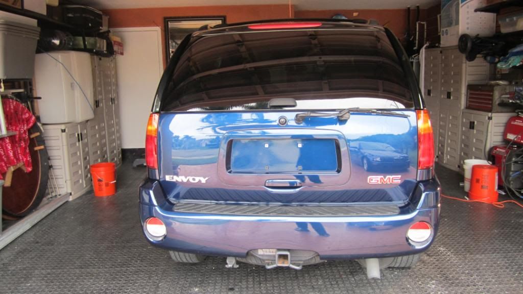

rear trunk door AFTER SEALANT

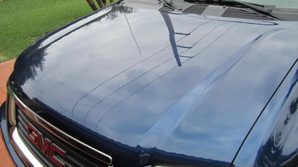

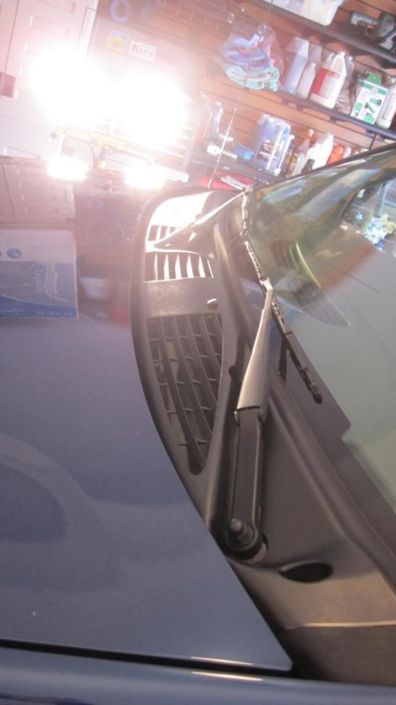

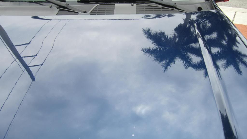

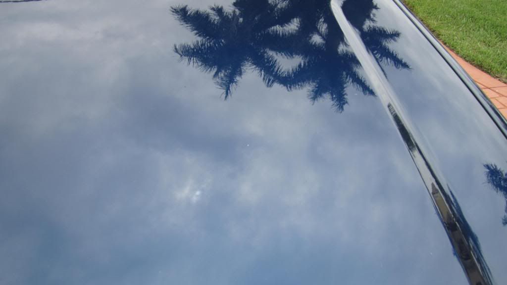

hood after SEALANT
rear fender panel AFTER SEALANT

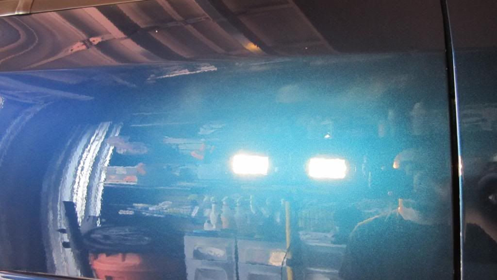

another shot

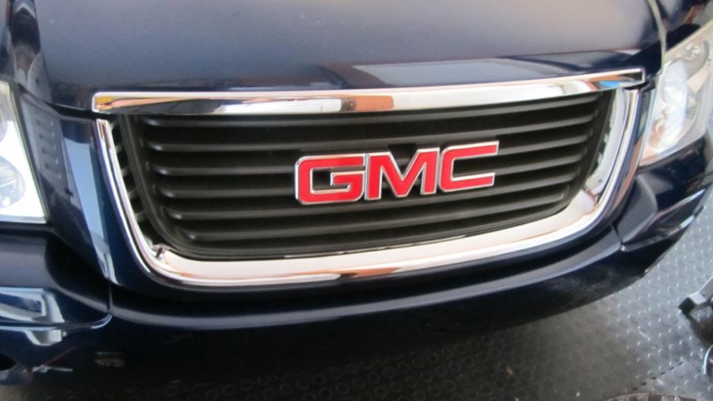

UTTG 50/50 YES, IT IS DRY AND THATS THE WAY IT LOOKS..AMAZING

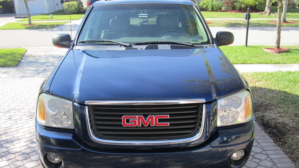

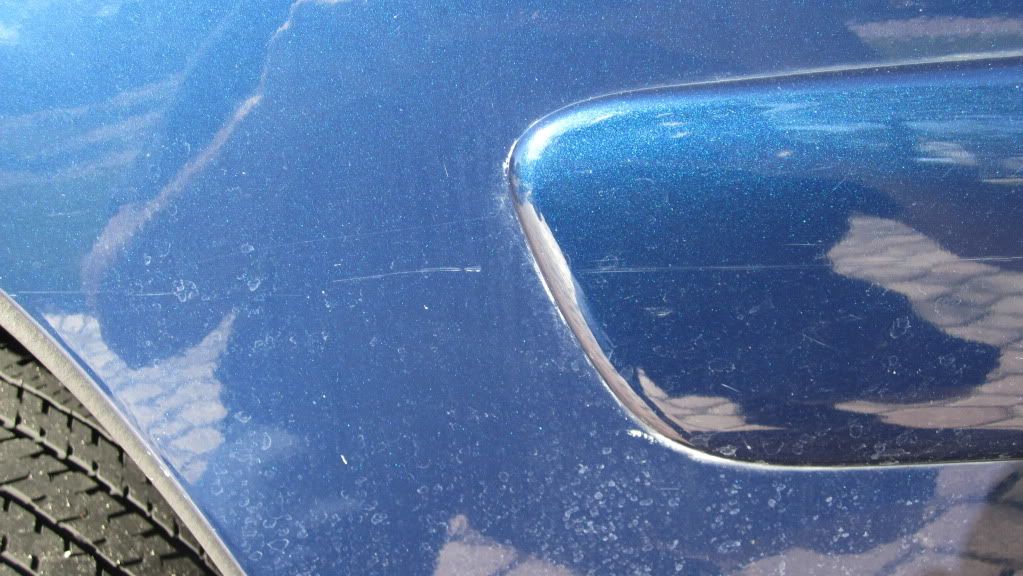

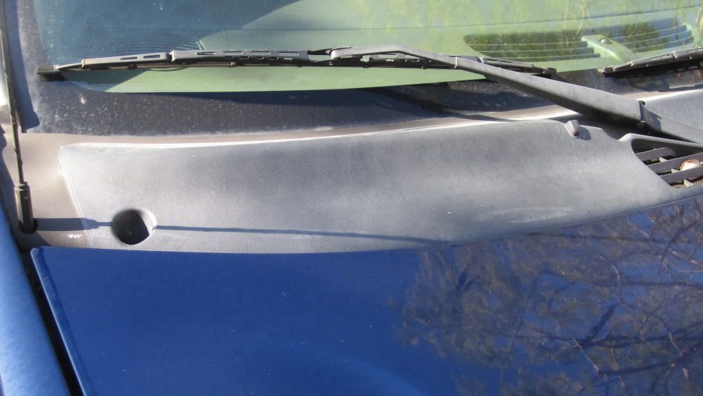

befores

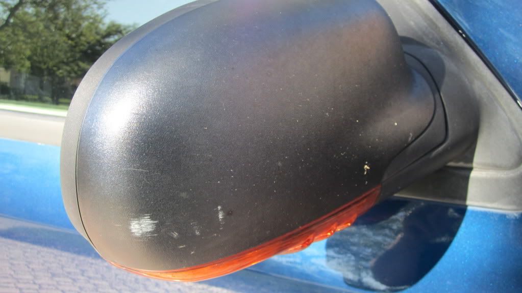

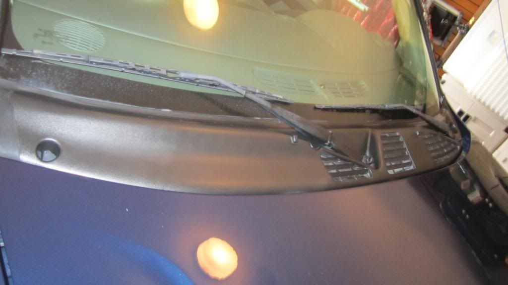

what can i use to restore this?
will optimum metal polish work good for these?
what grit wet sand should i start off with here?
what should i use to restore this trim?
would this need wet sanding?

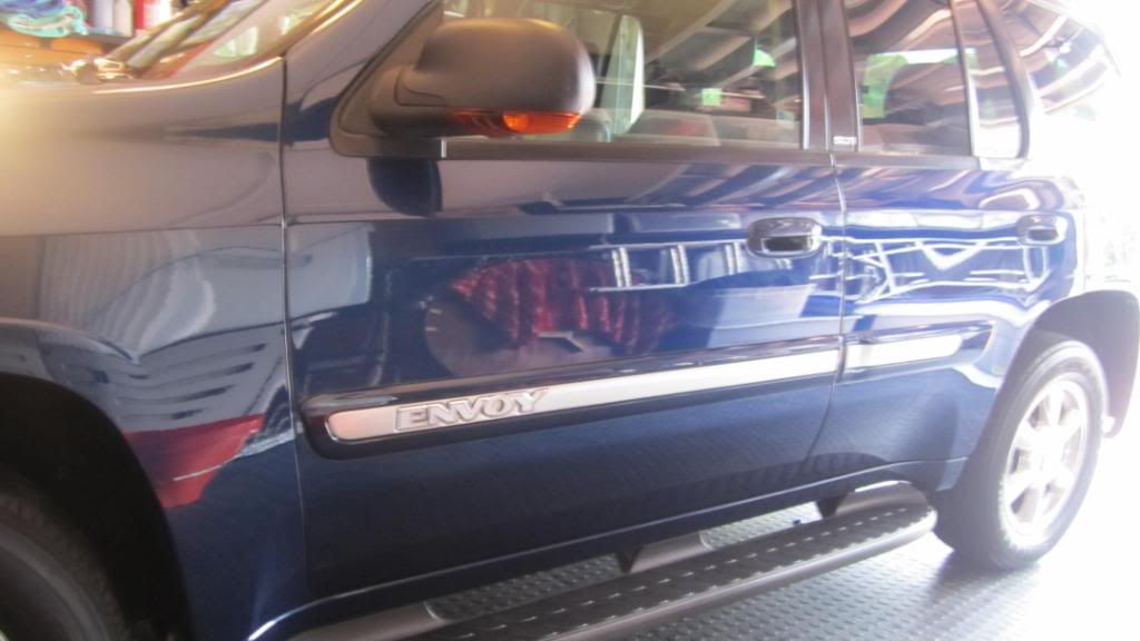

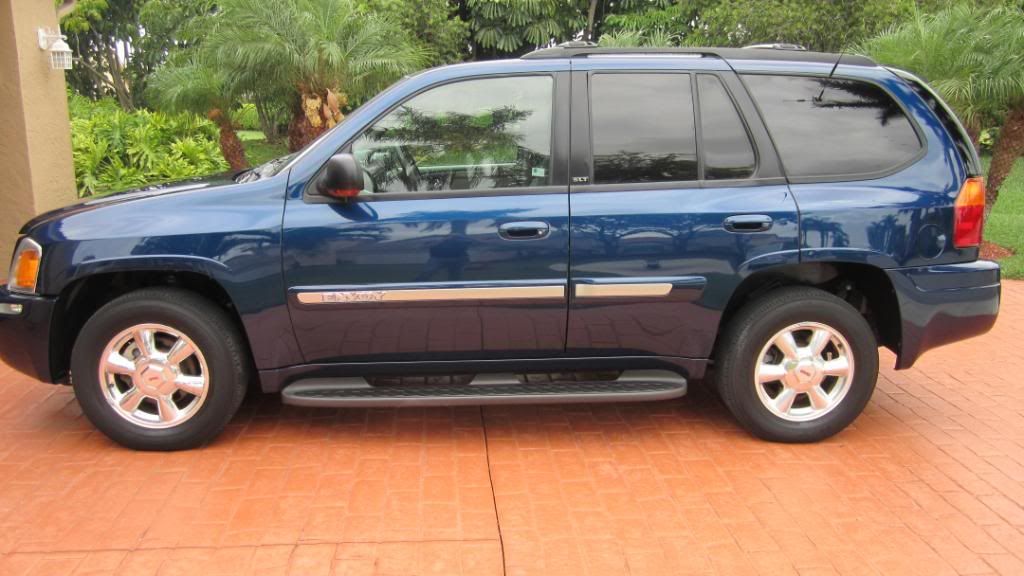

AFTER NO SUN SHOTS YET THE SUN WASNT OUT TODAY
notice the black trim is restored :)

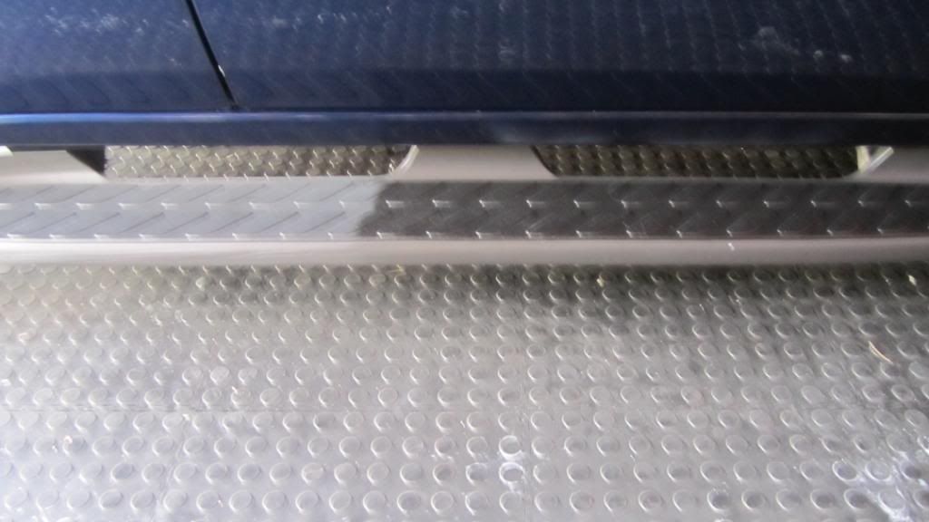

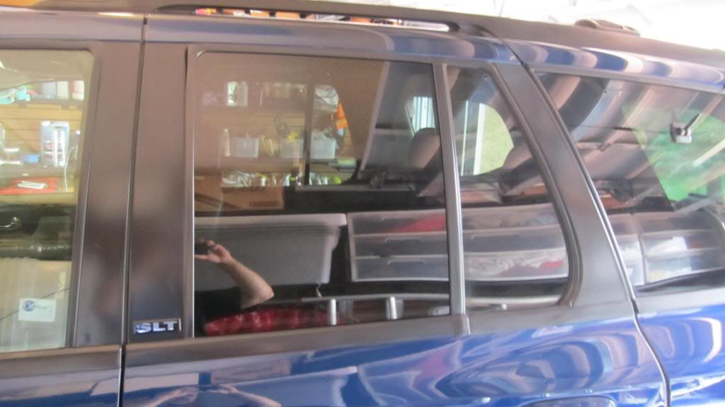

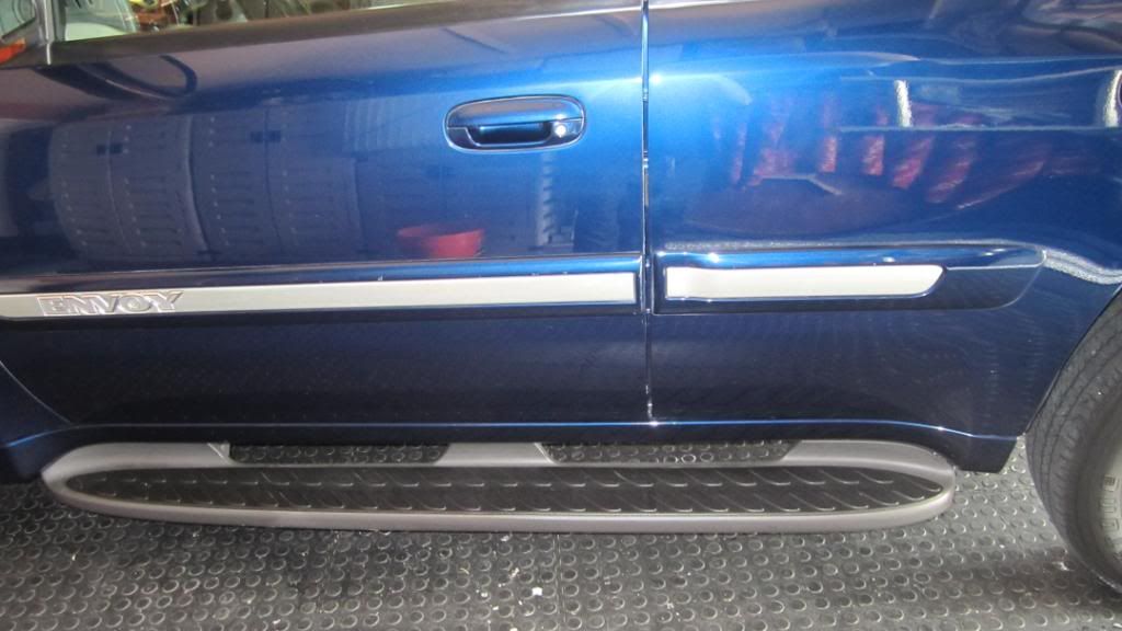

side steps restored back to black and window trim

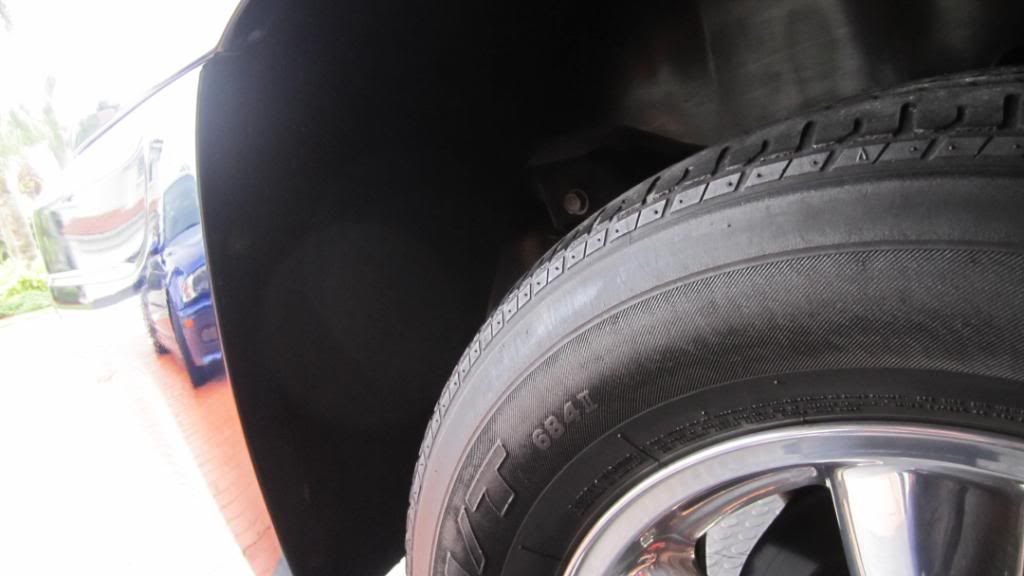

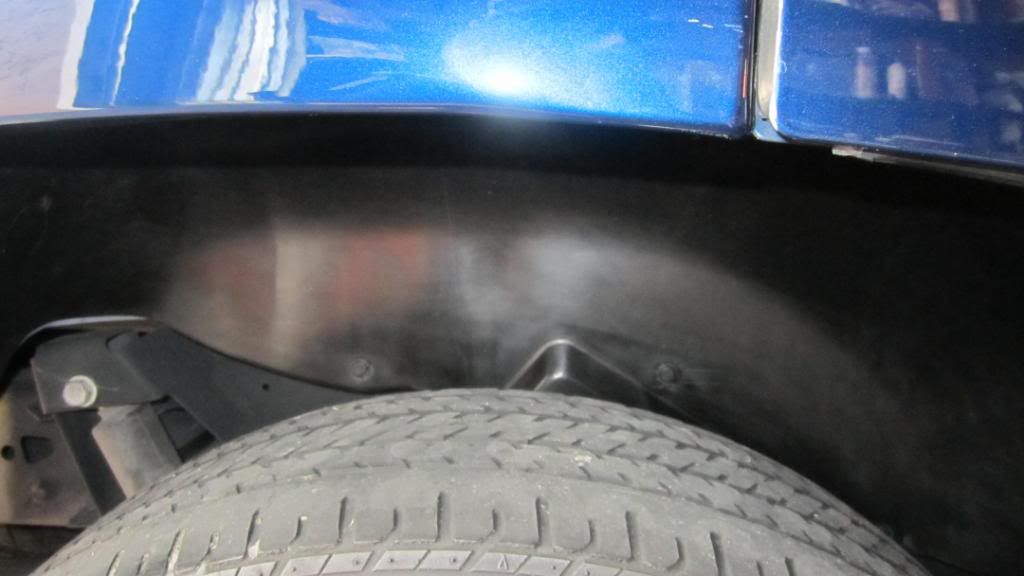

wheel wells cleaned and dressed

Looks like your next investment had better be in some new tires....
Yes shiny new tires I know lol. I am a little frustrated because I ran out of my QD and I used megs QD the one you get from walmart the purplish red bottle and all it did was smear everywhere and is being a b**** to take off..... The sun shots will be up hopefully tomorrow.

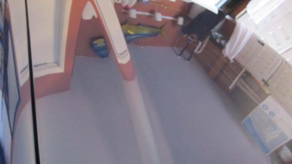

Awesome shots man...was a lot of fun to watch this thread from beginning to end...nice lookin neighborhood you're in too (could see it in reflection shots lol). Can't wait for sun shots...should be sweet. Also sweet garage set up as well :dblthumb2:
thanks will, yeah The day I planned on taking sun shots which was yesterday was cloudy and rainy same as today, I wish it was cloudy and rainy while i was working on the car instead of blazing hot and humid.. lol . and now that I finished I had no more QD and I used the megs QD from walmart .... worst idea ever...
