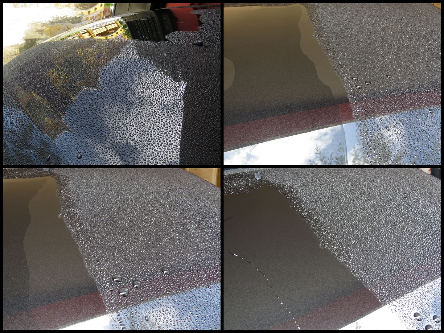

Here's a brief backgroud:
A month ago I put 2 coats of DP paint coating on the hood of my car to test out the product's durability. Paint was properly prepped ( washed with ironx soap , clay , polished, IPA , DP prep polish ) before the application. No boosters were applied after the weekly wash.
Beading and sheeting was excellent for the 1st 4 weeks.BTW, none of my previous LSP's ( waxes / sealants ) have maintained their beading and sheeting properties this long with our inclement weather. After the 5th week and with the unpredictable weather , paint has gone thru some serious beating causing the beading to be greatly reduced. There are some very light contaminants on the paint so decided to clay ( Mothers ). After claying , beading was totally gone but sheeting is still alive. Paint is almost dry after a few minutes.
Hood_DPC_1Month_zps905c6b96.jpg~original
Hoping to restore the beading back, hood was polished by hand with DP prep polish. Can't believe beading is back.
DP_Prep_beading_zpsac1cb959.jpg~original

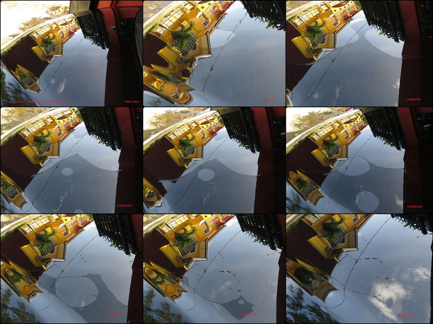

I was thinking if the DP prep polish has caused the beading, so i decided to wash with soap half of the hood to verify.
Beading_5050_zps25607f55.jpg~original
As you can see , the portion of the hood that was washed came out flat compared to the other side. But that portion was totally dry after a few minutes.
Here's a brief background:
Just to point out to those reading this in the future that might not look at where you live as it's listed under your forum name.
Manila
Nothing lasts forever, especially the crisp fresh waxed look after you just wipe any wax, sealant or coating off paint.
